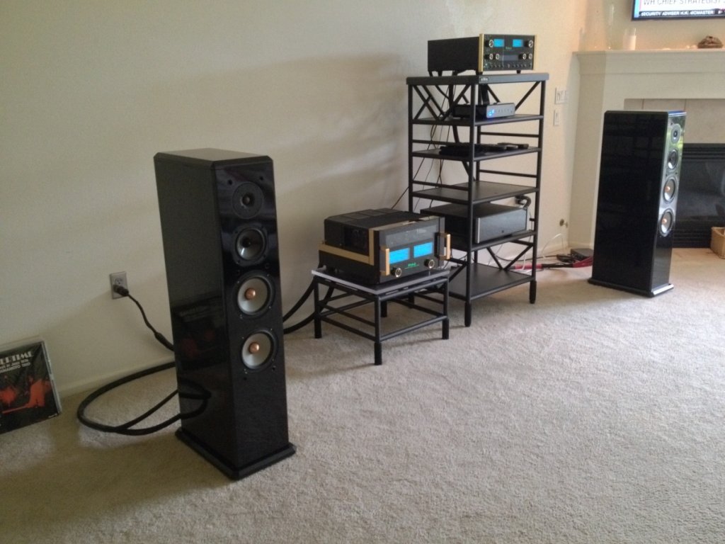

Just picked up these fine VR-5 HSE off Craigslist last week. Really starting to open up to them.

They look great.  Fabulous speakers.  Don't see many of these on Craigslist.

Once again, VSA with McIntosh. Great combination! Enjoy!
