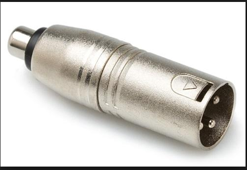

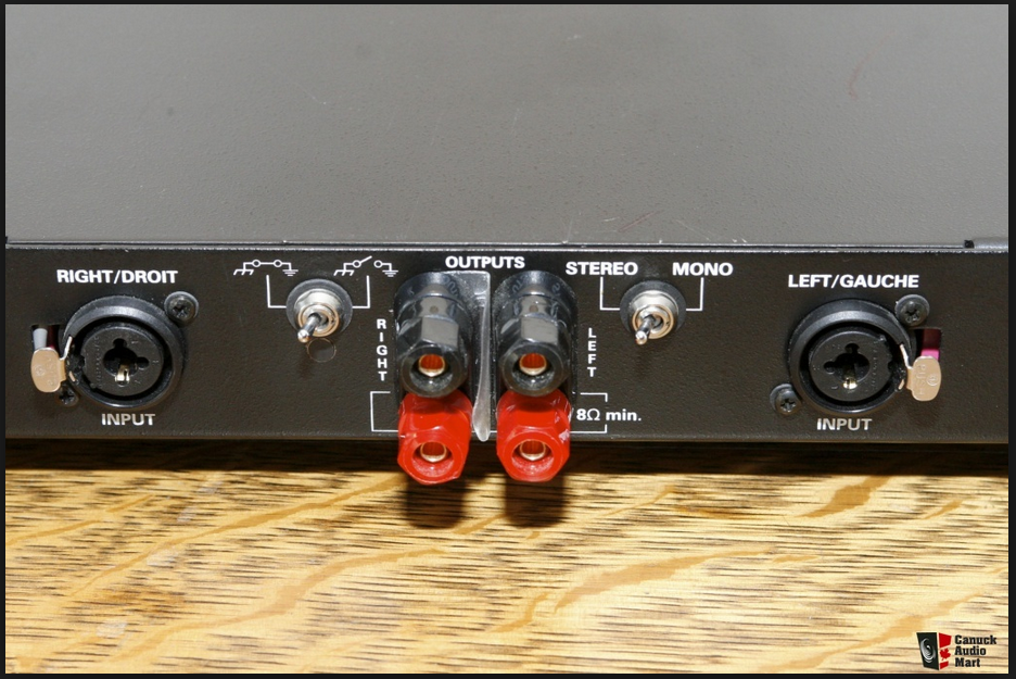

Also you’ve designated the .5 as non pro, are we to assume the 2BLP is the pro version with balanced XLR inputs.
If so are you using a XLR to RCA adapter, which may cause possible grounding issues.
These are the worst culprits...

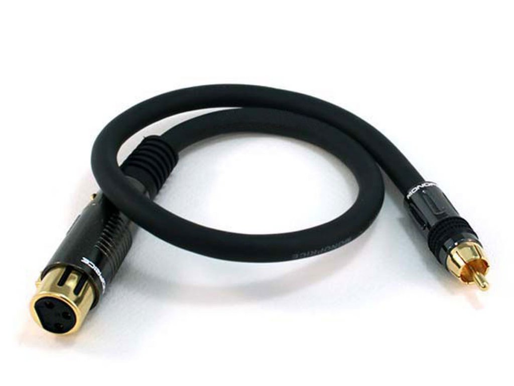

Having had multiple 2BLP reiterations on hand since 1985 I’ve had the most recent success by forgoing an adapter and settled on an actual RCA to XLR wired cables, one up to 50'.
Monoprice offers very affordable lengths so if all else fails you may want to give them a try.

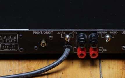

Does the ground lift, toggle switch on the left, help at all?
BrystonNewb
  • Posts: 3
Re: Hello and Bryston question
« Reply #8 on: 2 Feb 2018, 06:43 pm »
Howdy:
Ground lift either position doesn't seem to help, and with amplifier and just the speakers connected (no inputs to the amplifier) I still hear speakers hum.  Amp and pre-amp are stacked and I'm just using an MP3 player for now.  I will separate the units and see if that helps.
