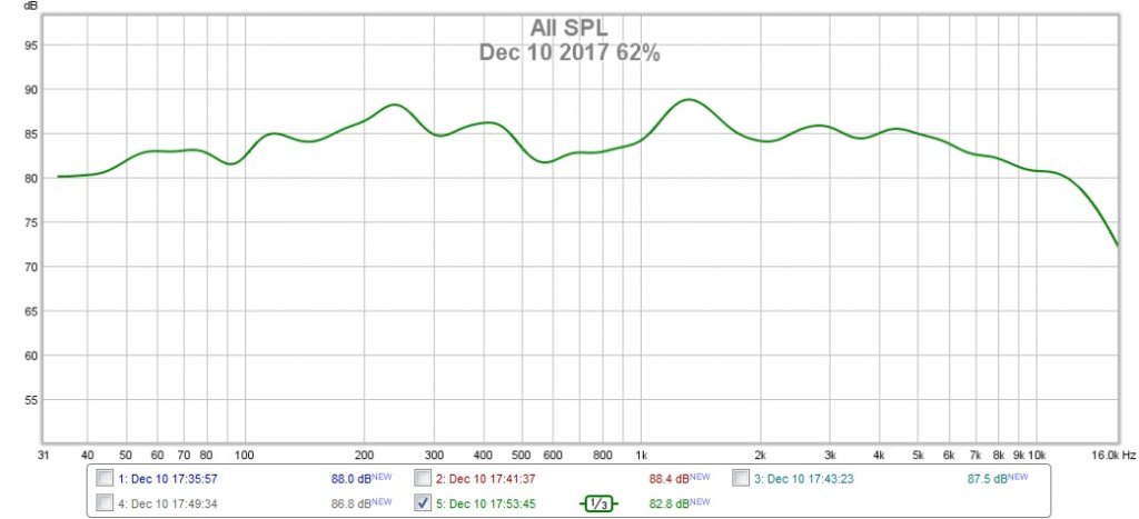

No difference. I strongly believe I don't need them now that I have moved my speakers and chair (mainly) to a better location and I now avoid the worst humps and dips in the room.
I like the look of them and the speakers are stuck to the floor because they are like mini suction cups. So I might keep them just because they are nice looking.
With further tweaking my SPL looks like this:

Nice work Pete.  Too bad the Gaia’s didn’t improve the sound.  I was more than curious myself.
How far did you move the speakers and/or listening position?
How accurately placed are your speakers to your listening position?  Within an 1/8”?  Better?

Yes, but the speakers have always been on a portion of that then and now. They're pushed back to the very limits of it near the front wall.
Guys, I think these devices can help, especially if the speakers are susceptible to vibrations, etc. My Exoticas improved when I put the rubber wafers under the feet and then the nicer looking Symposiums gave the same performance. Cleaned up the mids, etc. They were also in the bad spot.
My speakers are very heavy as I have lead weights in the uppers and the plinths are 3/8 steel with heavy copper feet. But, moving my chair more than 2 feet forward and the speakers almost the same backward put me out of the nasty intersection of several room modes. No isolation feet would make that much difference and then when you have better response, there is way less need to isolate the speakers from the "room".
Remember, I made room measurements w/o the Symposiums and placed them without. Then I added the Iso units at their final spot and there was no SPL difference. It was easier to adjust the speakers around the room w/o having to also slide the Symposiums with them simultaneously.
The speakers are within a 1/4 inch of their corresponding walls Terry.

I don’t mean to question your abilities as I’m certain you’ve tweaked and understand this stuff far more than I ever will.  I was asking about the accuracy of the speakers to your listening position, not the walls.  Walls are usually not that accurate, but I have seen high frequency roll off in measurements where the speakers are off 1/4” to the listening position.  Made me think of that when I saw your measurement, but I know the mics we use aren’t that great for high frequencies anyways.
It took me 2 years to place my speakers.  In the end, I stopped measuring and 1/2” speaker moves sounded different.  It’s a very tough thing to get right, and you can’t base it just on what measures best.  Even the thought of moving speakers makes me want to cry a little.
