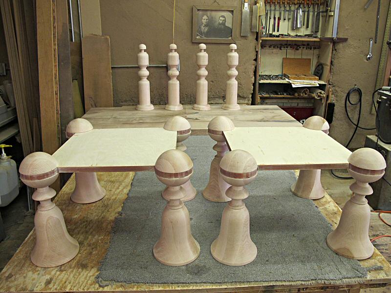

A few years a client commissioned a very ornate coffee table and stools, not something I usually do but I like a challenge.
The coffee table top was made from combo-core plywood that has an MDF top and bottom for a super smooth, flat surface.
The legs are turned from hard maple.
The finish used was Sherwin Williams Sher-Wood Kemvar Conversion Varnish, a high solids catalyzed wood finishing system offering a superior quality for furniture, cabinets and interior wood product. Kemvar is a catalyzed colored varnish so you need a spray booth with an exhaust fan and a lot of time. Finishing will take as long or longer than construction.
Kemvar Sealer—catalyze and reduce Varnish as a sealer. Spray a full wet coat. Air dry 30 minutes, sand, repeat, sand, repeat.
The client wanted a distressed look so the parts were first sprayed a deep red then either black or cream depending on location and rubbed through. A clear coat of Kemvar Conversion Varnish added another layer of protection.
Prime coat
Finished stools and table in clients home
Wayne

The stool tops are 3/4" plywood with a thin layer of MDF on both sides. You could hop up and down in the center of the stool, on one leg, all day long and nothing would break.
The table top is 1" thick, solid enough for a dance party. There is a support and leg in the center that is hidden by the books.

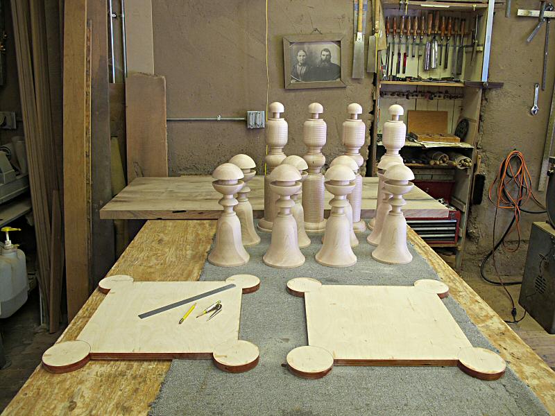

Stool parts
Caps are cut off and glued on top of plywood. Plywood edges have been filled, sealed and sanded before glueup to preserve the double line detail and 1/16" reveal around the top.
