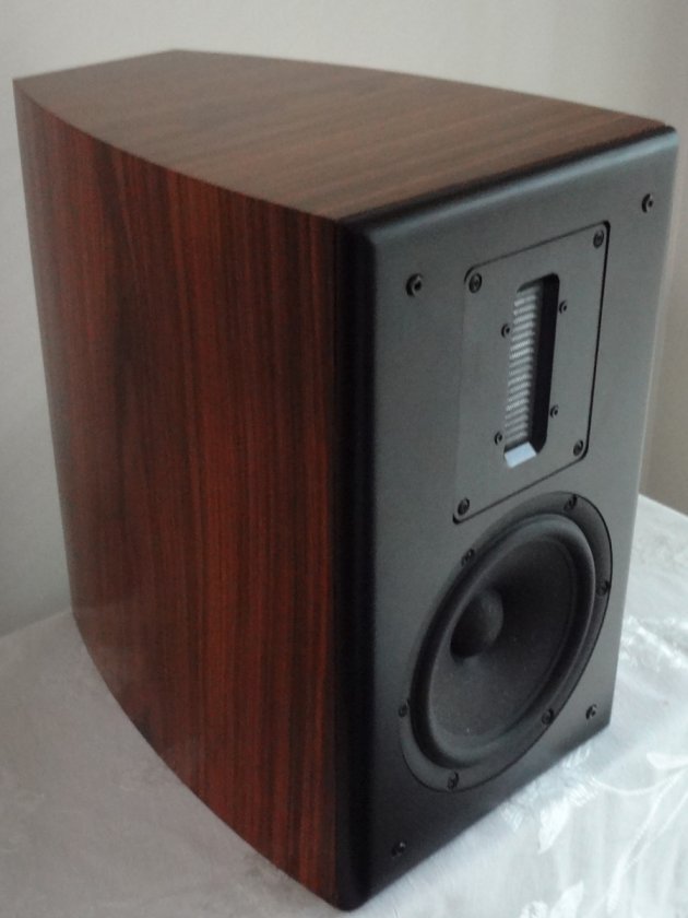

A Canadian customer requested a sealed box version of the Anniversario. Enjoy!

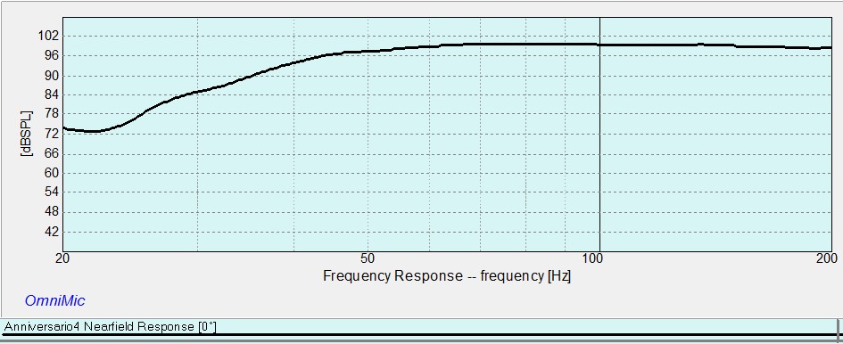

Actually the bass is quite nice, especially with reinforcement from the rear wall and /or a corner. Here's the nearfield response of the bass (no room gain included).

Looks like roughly -3db at 55Hz and -6dB at 45Hz? That's actually quite impressive!
Yes - the sealed box has a slower roll-off.

At 115db???  :o Those woofers must be coming out the box and smashing you in your face!!!
That's nearfield, about 1" from the cone of the woofer :)
Would it be possible to see an overlay of the ported vs sealed charts?

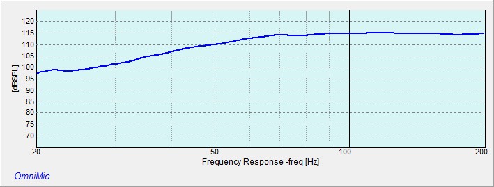

Re: Montreal Monitor
« Reply #10 on: 25 May 2017, 09:03 pm »
Sorry - they were taken at different levels so an overlay wouldn't be very useful. Here's the ported curve:
smilach
« Reply #11 on: 26 May 2017, 02:10 am »
That looks similar to the cabinet you used for your Vicino.  I'm sure there is an upgrade in the crossover components and of course, the MUCH better drivers!  :lol:
