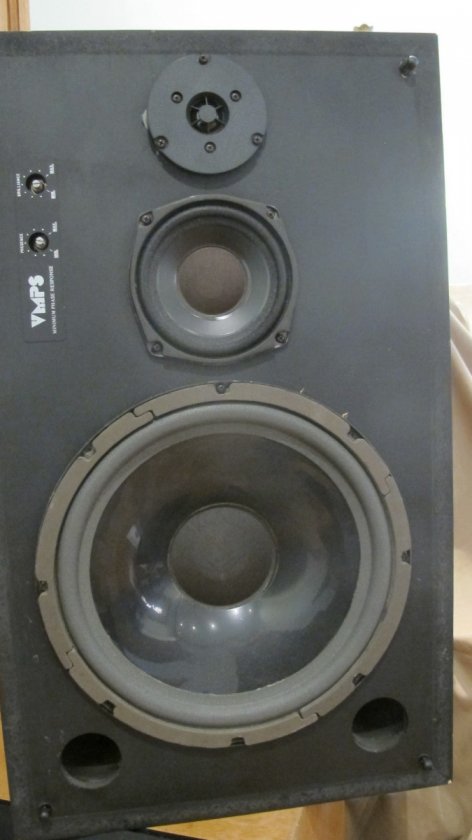

So, basically, someone owned this type of VMPS speaker:
And turned it into these!
This was an upgrade mod offered by Brian for the FF1 and FF3 speakers.  Heck, Brian probably personally performed the mod.  The original Dynapleat mids are removed and sealed off, the tweeters are upgraded, and the new mids are added as wings to the main cabinet.  BG mids were the early option.  A bank of the Sonigistix-Monsoon planar mids were a later option.   As such, I wouldn't sweat it.  Or even worry about the schematic (which are hard to come by).  It'll be good.  All you need is space and a lot of power.  Space to give the speakers room to breathe, and a good amount of power, because those woofers and the BG mid can handle a lot of watts.  Just be sure to adjust the passive radiators too, to match your room and equipment, and you'll be fine.

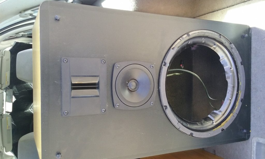

I got curious and carefully peeled off the foam from the front baffle. Twin tweets (why 2?) look to be Aurum Cantus G3's although the labels have been removed. The front baffle, which was of course modified when the update was done, is incredible. They look like solid oak lined with two layers of 2/3" MDF. No wonder they were so hard to get into place!
There is no third woofer or passive radiator on the bottom, that hole has been plugged too.
Brian didn't believe in cheating the laws of physics!  Big cabinets for Big Bass.
That's not good.  Those woofers are designed to be ported, and need the passive radiator.  Since they're FF1's, I'd think they need a 12" passive.  Or, with the size of the cabinets, you might have the depth for a side-mounted 15" passive.  Like the final version of the RM50's.

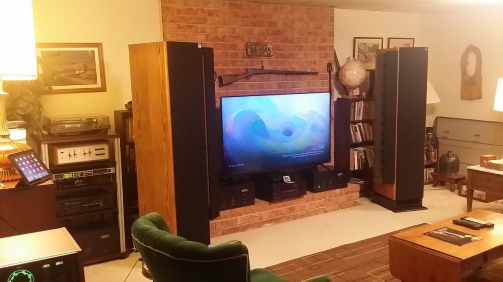

They're all dialed in with my new Behringer DCX2496 and sounding lovely, lovely lovely. I have to say, at the risk of insulting VMPS fans, that the stock crossovers don't even come close to making these speakers sound right. Brian used a DCX2496 at his live vs recorded demos, which says a lot. The sweet spot is tiny, (almost Quad-like) because the vertical dispersion of the double Aurum Cantus G3SI's is pretty much nonexistent, but oh do they sound good! A proper passive crossover (which I just might build if I find the time and energy) for these would have at least fourteen components, not four like the stock crossover. The Behringer is set for L/R4 on all 4 filters, crossovers points are 238 and 3850 Hz. I EQ'd out the cavity resonance peak in the BG's and the 14K-22k peak in the G3SI's and did some room tuning. Next step is to bring in my JBL 2245 infinite baffle fireplace sub.

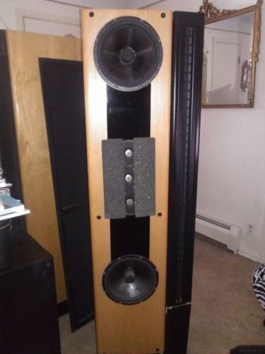

>I removed the grille cloth from the mid panels and was shocked to find six Monsoon/Level 9 panels in a line instead of the BG RD50 I expected.

As far as equipment goes for digital (mostly 24 bit)  I usually take the digital output of a Chromecast Audio and send it to the digital input of a Behringer DCX2496 and then on to 3 BGW 620Bs. I split the analog LF output of the Behringer and send it to an analog 50 Hz/LR4 low pass filter into yet another BGW and my subs (yes, I'm "quadamping" if that's a word). For analog or HT I use an  SAE MKXXX preamp, and my Sony PS-X5/V15II or my Pioneer F91 tuner. My HT setup is a little too complicated to go into here.
I used my ears and REW 5.1 software to set up the DCX. They sound like big Quad 57's that go low and play loud.
