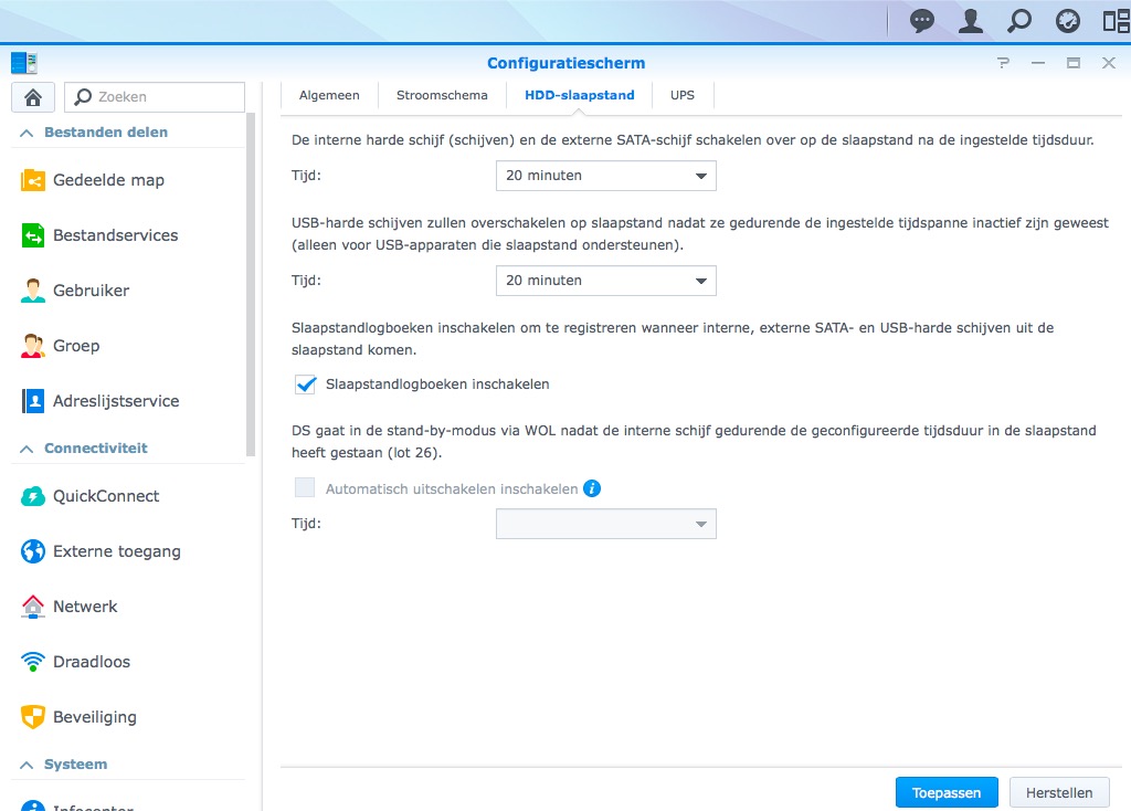

Below are the settings that I use on my 1813+ and it works as it should.  I would suggest to "reset" the page, reboot and set them again and then reboot again.  That should do it.   Also make sure you're on the latest software too.  This is very important.
Marius
Re: Synology NAS won't hibernate - BDP causing it?
« Reply #10 on: 14 Feb 2015, 10:19 pm »
HI Thanks!
looks almost the same overhere:
missing the enable deep sleep though, will try to find out about that.
Did find a log entry: CIFS client [admin] accessed shared folder mp3
investigating further....
