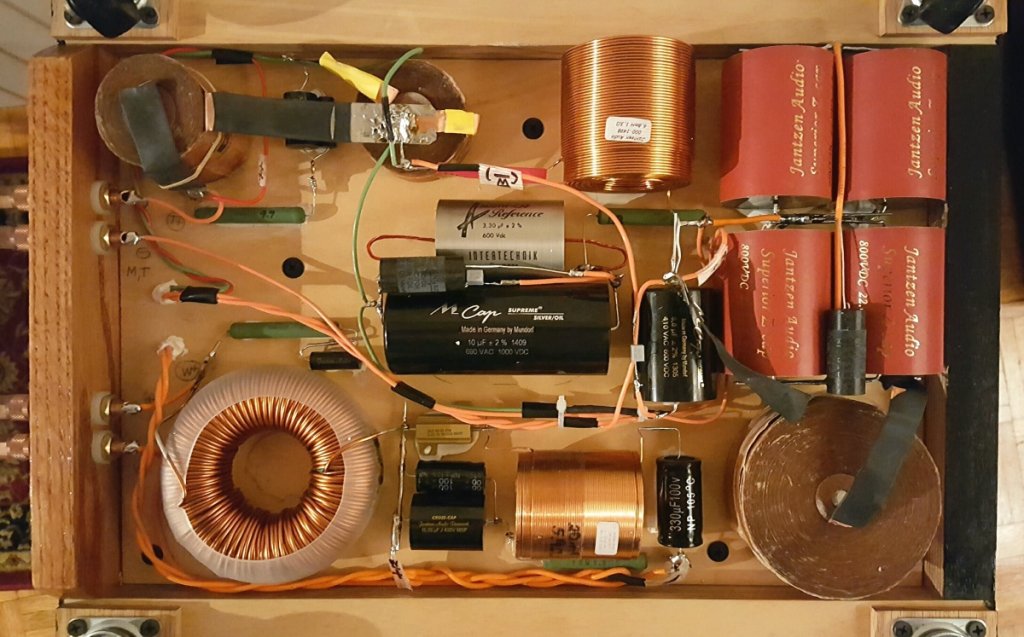

Rollo and Big Red Machine: I'll try the plummer's tape and check out the Furutechs. I was just looking at those a few days ago at Sonic Craft for my 6N1P/KT88 SET amp.
After biasing, I wonder if the amp will sound less bright and etched?... I don't think my AudioQuest CopperHeads help either. So, I've ordered some Shunyata Venoms to try because of their neutrality.
I'm asking because I recently revoiced my 13" 3-way DIY speakers by -1 dB on the tweeter resistor to match the sonics of the unbiased amp. I also changed the overly rich 70% Mundorf Evo Oil + 30% Jantzen Superior Z to 100% Jantzen Superior Z for the large mid cap for improved coherence. Then I added some bypass caps to fine tune the voicing process.

It seems biasing is another form of voicing, as well as to control my initial problem of the amp generating a lot of heat. Ultimately, this voicing procedure will depend on the line voltage, speakers, components, cables, room, and taste. It's good to know that 21.5mV is neutral, and I'll start there. Once I establish the bias, I can also tweak the tweeter resistor on the crossover to tailor the sound. Good thing with DIY speakers, everything is accessible and/or expendable. ;) I'm going to have a busy weekend. You guys have been awesome!

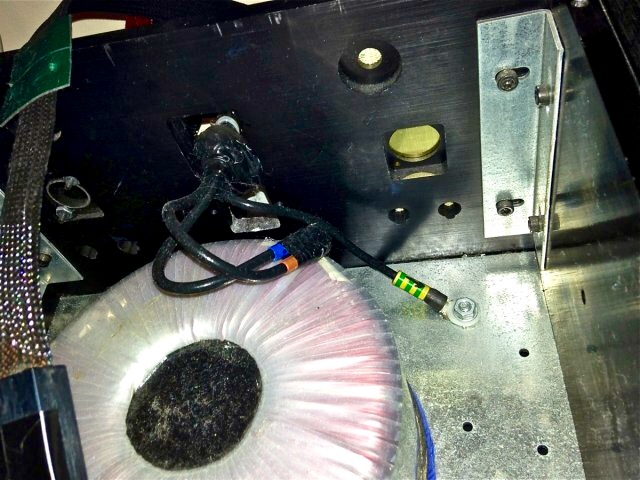

Sorry for chiming in so late. For the ultimate sound quality I have BYPASSED the IEC Connector Socket on my FRANKENSTRATOS. I have hardwired the Mains Cable directly onto the TORROIDAL TRANSFORMER. This gives the cleanest sound with lower distortion...
