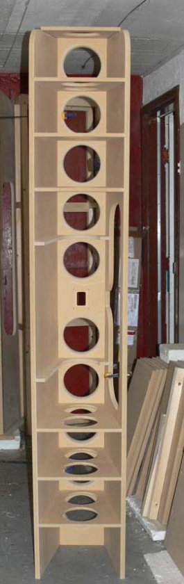

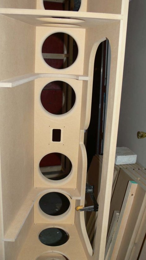

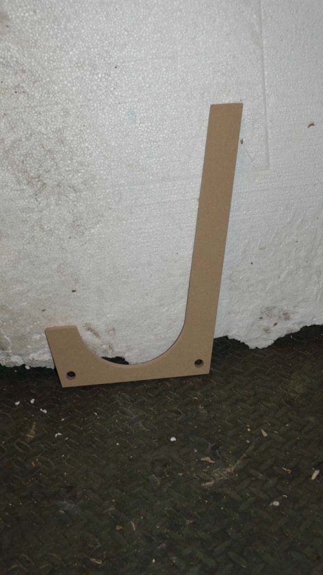

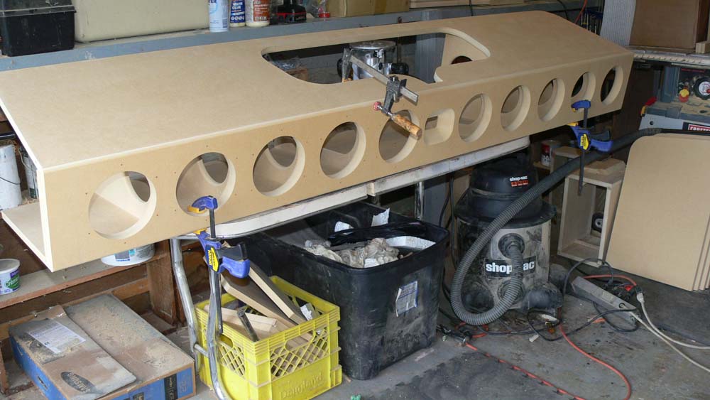

« Reply #25 on: 17 Oct 2016, 01:51 am »
Here are a  few pics of the  revised cabinets  Had a feeling there'd be extra bracing  needed (barin cramp on my part, should have just  done it from the get go  :duh: ). Added  2 more full braces and a pair of half , or  "j-braces" as I like to call them   :lol:
They all fit in dados so it's all pretty much self aligning
Add the outer or open wing  that has been altered to matchthe new driver compliment along with a bit of an extension to the short section. Note, this is a defective baffle, you can see the radius on the edge disappear as it extends down the  baffle. Also  woth noting, the bevel on the  bottom has not been cut.
A shot of the braces from the rear,  it's all a really nice fit
One   closer in of the  j-braces and how they integrate with the baffle/wings
