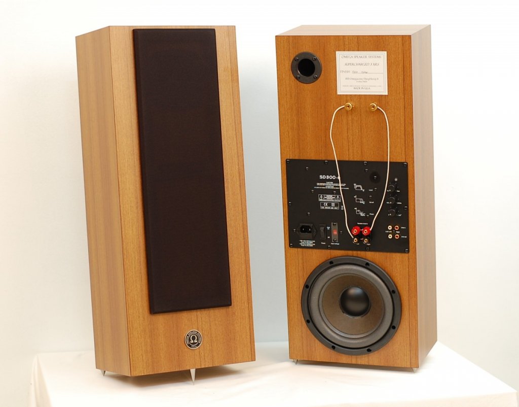

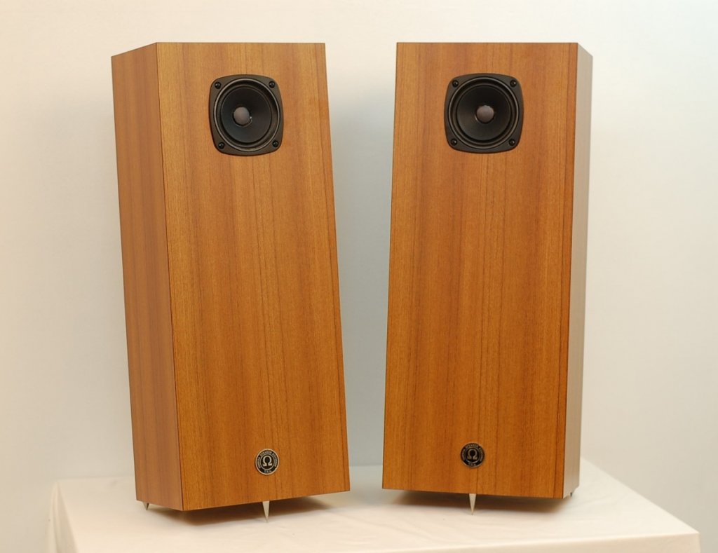

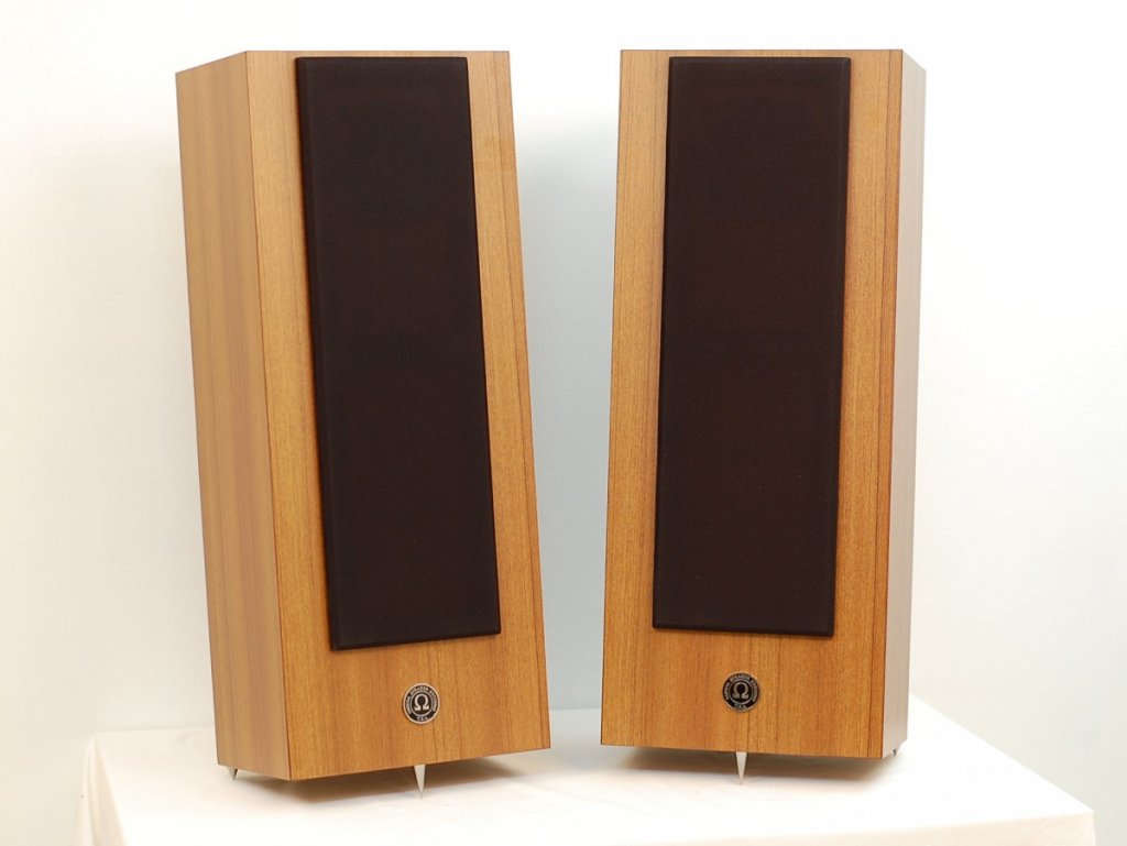

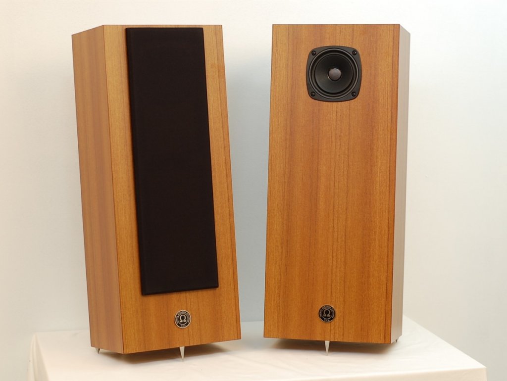

Hi All,
Just finished another custom that I have done before.
Big sound out of the Super 3 XRS. Active bass clean looks and can be also used with subs off.
Louis

« Reply #3 on: 24 Sep 2016, 09:52 pm »
these must be freaking monstrous with hip hop or Reggae

Re: Pictures of a Supercharged 3XRS
« Reply #4 on: 26 Sep 2016, 02:38 pm »
Hard to believe that's a level 1 finish (EKO Teak).  Wow!

Hi guillaume bougard,
They do and I ran Reggae through them and they go low. Being that the woofer is hidden and the cab is so small it's really mind boggling.
Thanks Canada Rob and I also found a great EKO Walnut. It's really nice I'll be posting it soon. Walnut has been very popular and this is a great level 1 choice.
