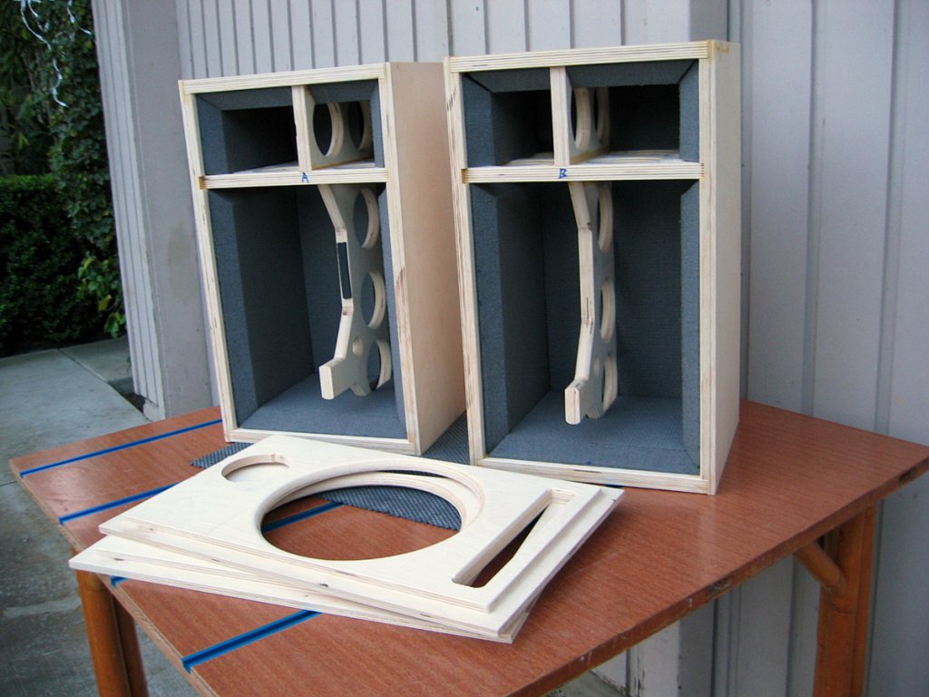

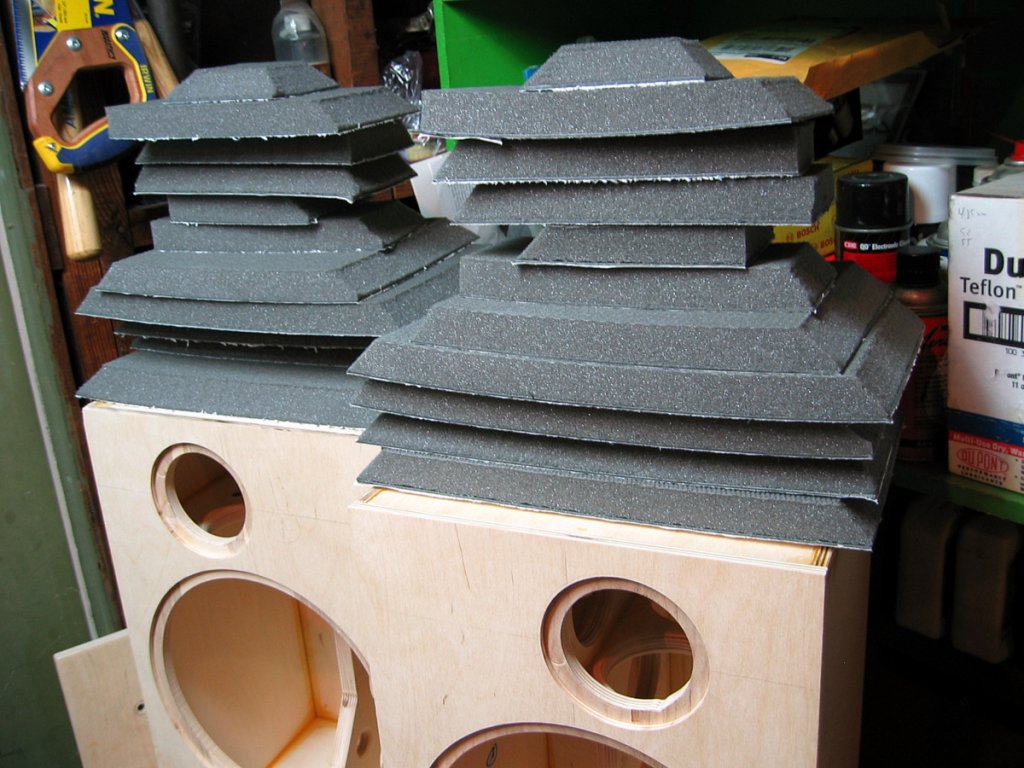

Today I cut and mitered 22 pieces of No-Rez for a SEAS A26 build with Baltic Birch.
Question #1:  Apart from making the wood surface free of dust and particulate, is any surface treatment like primer beneficial here to make sure the No-Rez sticks for decades?  I used No-Rez twice before on MDF, one primed and one not, and it worked out great.
Question #2:  Normally I cut the foam part back 1" from the baffle and leave the damping for that 1".  Would a 45 degree angle do just as well?
BTW, Bosch jigsaw with wood blades worked great but took a few blades due to the rapid dulling caused by the damping layer.

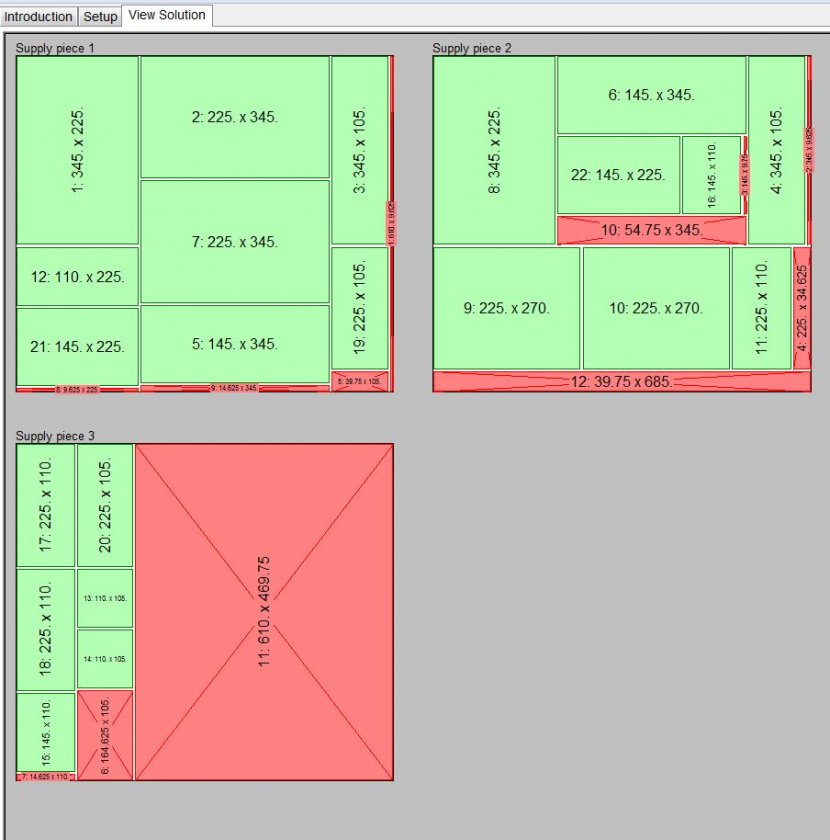

Another tip - the free program Cutlist 4.04 is invaluable for laying out sheet goods and also No-Rez to minimize waste!!

Sweet looking 45 degree cuts!  :thumb:
Both times I used No Rez was on unprimed MDF. Sticks like crazy. My cuts were strictly low tech - I used an old bread knife with a serrated edge.  :lol:

Question number 1: So long as the surface is clean and dust free then it will stick like crazy.
Question number 2: Your 45 degree angle will work fine.

I didn't miter the baffle facing edges yet and left them square, but the jigsaw will make short work of that.
In the past I've used a utility knife and razor blades to cut No-Rez.  Definitely prefer the jigsaw/edge guide outcome.
My Cutlist image is attached - great little program.  I did a second pass for the 45 degree cut (double the work, twice the fun).

I've had good luck cutting No-Rez on a bandsaw. Clean easy cuts with almost no blade waste.
jparkhur
Re: No-Rez install
« Reply #5 on: 22 Feb 2017, 07:11 pm »
I love the band saw cuts.  I do use a table saw for the 45 degree cuts. No waste and slices like butter.
