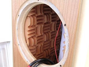

both are great ideas... do a search for bracing. i think this topic was discussed in the vmps forum earlier.  my odyssey lorelei speakers do not have any bracing-instead they have acoustic foam lined all throughout the inside and it passed the "knuckle test" so I think either method will provide an improvement.  here's a pick of the foam lining the loreleis:
hope this helps.  good luck.

Well, I'm off to void my 10yr warranty within 2 months of purchase.  Thank you for the reply, what sort of acoustic foam is that?  Purchase source?  I dont know what sort of acoustic damping is inside these speakers at present, but will check it out shortly.
