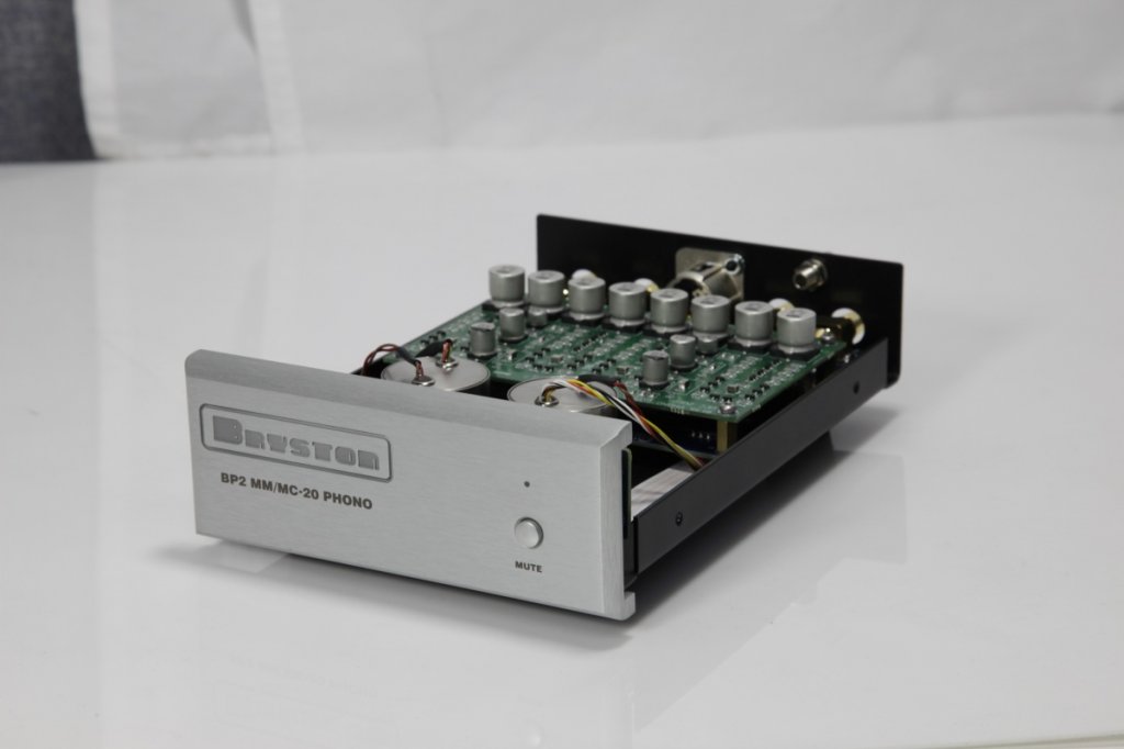

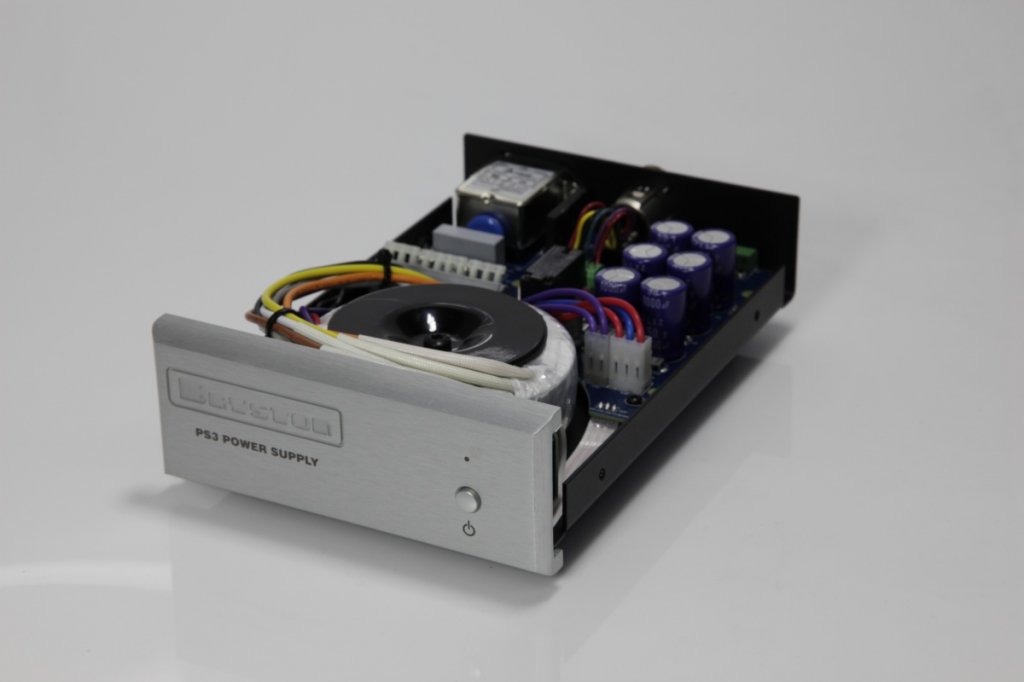

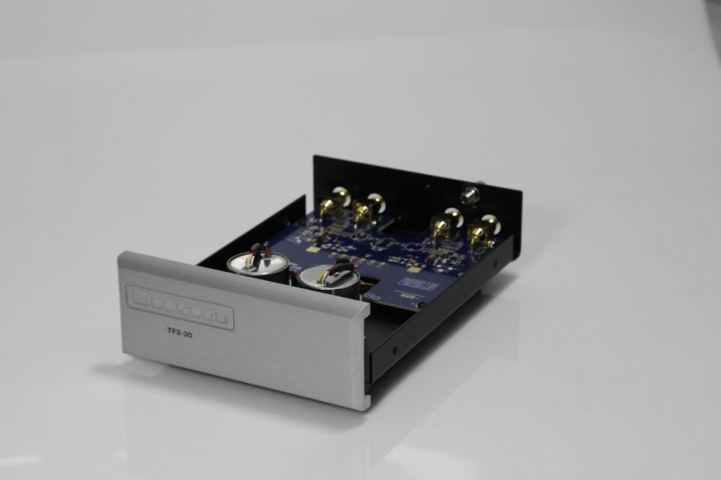

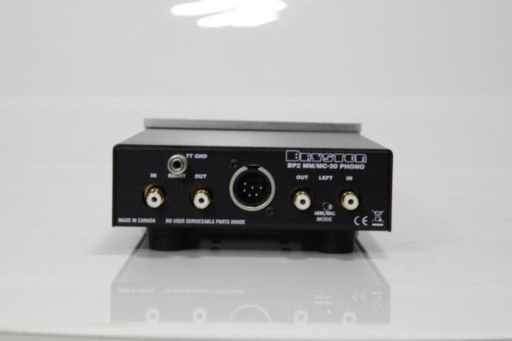

New Phono pics:
MM/MC STage
MM/MC Rear
Power Supply
TF2 MC Step-Up Transformer
