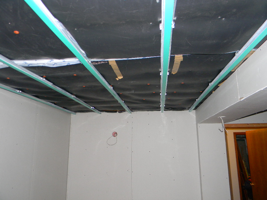

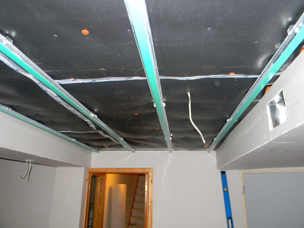

I'll do a full build expose when done. Here's a teaser of the hat channel with integrity gasket prior to double drywalling the ceiling with greenglue and caulking the seams.
Can't imagine doing this without a drywall lift (last build I did) and with one of us 6' 4" and me 6' 6". Step stools were an annoyance. But lots of looking and reaching up. 8+ hours of effort for 16 sheets after I spent almost 4 hours prepping by putting up the channel and adding the tape.
