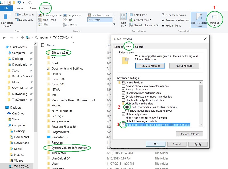

Windows 10 is weird.
It adds a System Volume Information folder to every external drive (and why the $recycle.bin folder?) and I found a _disk.id.pod file too.

« Reply #50 on: 29 Jun 2016, 12:04 am »
These folders are not unique to Windows 10 and also exist on Windows Vista / 7 / 8.  It just sounds like you happened to have enabled viewing of hidden and/or protected operating system files.  They've always been there but were hidden.
The $Recycle.bin folder exists on all your internal drives and partitions and most USB external drives, but not necessarily small USB flash drives.
System Volume Information folders are where Windows stores Restore Points.  You can go to Control Panel > Recovery > Configure System Restore if you want to turn off protection for a particular drive or manage/delete restore points.

It's a new Windows10 machine - it's just automatically enabled I guess.
The default should be to hide both "hidden" and "protected operating system files"
In a Computer window select the View tab
  • Click the Options button at top right, select "Change folder and search options" and select the View tab in the Folder Options window
  • Under "Hidden files and folders" select "Don't show hidden files, folders or drives" *
  • Check "Hide protected operating system files (recommended)"
* The "Hidden items" checkbox in the toolbar ribbon controls the same setting as the "Don't show hidden files, folders or drives" radio button in Folder Options, it's just worded inversely - check to show, clear to hide - and duplicated in the toolbar for convenience

Awesome! They're gone, thx agin!
