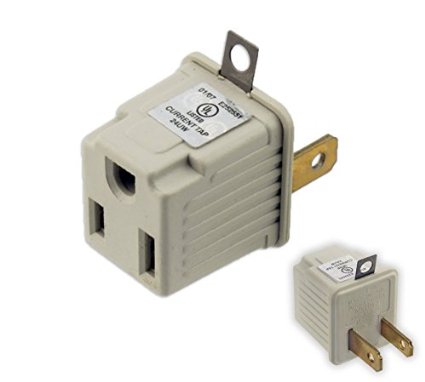

Here is a plug, by its very nature and soulful purpose is to defeat the ground, and UL says that that's OK. They even gave it a listing number.
And of course it's purpose and use is not to defeat the ground when plugged into a grounded receptacle and circuit, but only to give the ability to use a grounded plug device in a home that only has 2-wire ungrounded receptacles and circuits.

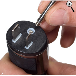

http://www.audioadvisor.com/prodinfo.asp?number=PSPWAC3
Yes, PS Audio says it is to be temporarily removed for testing purposes only.

UL listed "cheater" plug:
I'm afraid some of you don't know who, which one your talkin' about........
It is not UL Listed to be used as a ground cheater. It is designed and manufactured as a 3 wire to 2 wire adapter.
No, it is not UL listed for the use of lifting the safety equipment ground from a piece of equipment or appliance. It was designed by the original manufacture as a device for connecting a piece of equipment or appliance that has a 3 wire cord and plug to a 2 wire receptacle that is fastened to a metallic outlet box, which is connected to a metallic conduit that is electrically continuous all the way to the grounded metal enclosure of the electrical panel it is connected to.
The metal tab on the 3 wire female/plug adapter is connected to the equipment ground contact of the female receptacle. The metal ground tab is designed to connect to the 6/32 threaded hub of the wall duplex receptacle by the 6/32 cover plate trim screw.
The 6/32 threaded hub is connected to the metal yoke, the receptacle supporting back strap, of the duplex receptacle.
