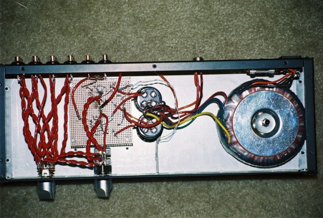

Dan,could you post a picture of the inside of your linestage showing the routing and physical location of the wire runs inside the chassis. It sounds like you are describing interchannel crosstalk or capacitive coupling between the channels via the wire routing technique used.  Without a picture I am conjecturing here about why the loss of stereo separation occurs.  This image
shows how I wired the input wiring in my buffer  to the selector switch.See link below. What is not obvious from the image is the spacial separation between the wires.  The back panel is the ground plane for the input signals. The jack's ground is common to the backpanel no isolating washers are in use.  The appearance  of a twisted pair
of wires carrying the signal to the selector switch is an illusion. Only the hot leg is switched. The ground leg is only connected at the jack and is floating at the other end.  This technique of twisting wire around the signal hot and connecting one end to ground is used to reject hum and add capacitance to the wire run without resorting to using shielded wire.
http://www.audiocircle.com/image.php?id=1205
I spaced the wires as far apart as possible to avoid interchannel crosstalk and bleed through between active sources. The potential for capacitive coupling exists at the selector switch and the DACT stereo potentiometer.
The dual mono board layout helps minimize the loss of stereo separation.
The buffer performs better than it looks.. Scotty

Hi Scotty: First of all I would like to thank you for your post. Here's a link that shows the inside of one of my pre amps.
http://www.audioholics.com/productreviews/avhardware/SCPA1p2.php
  From what you describe it appears you have some grounding issues inside your unit and when I have time
 ( either later on today or this weekend) I will offer up some ideas that you may want to experiment with.
                     d.b.

Hi Scotty:
   I have looked at the pictures of your unit and I have number of things I am going to recommend. Please bear with me as this is going to get a bit involved.
1.   Isolate the back panel RCA connectors, most of these connectors come with do come with chassis isolators so I hope they didn’t hit the trash.
2.   Most of the chassis connectors come with solder tabs for the ground connection. What I have done on a number of units is to solder a 1/8 inch flat braid connecting all of the input right channel connectors on the back panel and the same for all the left channel input connectors. This may seem a bit extreme but there is going to be a method to my madness so to speak.
3.   We now need a ground to replace the one you used to have on the back panel. Classic textbook procedure tells us we need to put this right on the perf board you are using. Strip  about 6 inches or more of wire and install it on your perf board. Connect ALL of your grounds to this wire. This will establish our center point ground connection.
4.   For the signal wires going to and from the Volume Control, ground the signal wires on the board. For all signal wires going to the back panel they should be grounded at both ends. On the board and on the back panel RCA chassis connector. For wire choices I have made some suggestions to Mike’s post that you may wish to further investigate.
5.   I’m not sure how you are grounding the chassis, so I’m going to make a few stabs in the dark here. If you are using  a two prong AC input then your perf board ground should be connected to the chassis at the ground of your unregulated supply. If you are using a three prong  AC input then please get back to me as we have a number of options.
I have outlined a lot of work for you. Take your time because this kind of stuff just isn’t done overnight. If you find yourself overwhelmed walk away for bit and come back to it later. The other thing you can now say to your self is that you have just joined the ranks of experienced professionals, and you are now in the learning process that the rest of us have gone through at one time or another. Dare I say that you will be rewarded with the final results?

_scotty_
The Importance of Wire
« Reply #12 on: 31 Oct 2004, 02:11 am »
Dan, thank-you for your suggestions. The perfboard has a star ground point
for both channels after the regulators and the ground from the pot is taken to it. The circuit is isolated from the heavy charging currents in the main supply by not having a direct connection to the center tap on the transformer.  The back panel
was chosen to be the low impedance reference plane for the signal ground.    The red 12Ga wire jumpers from the star ground point on the perfboard  over to the signal ground reference plane on the back panel. The back panel is then connected by a 12Ga wire to the
to the center tap at the main supply on the Jensen caps.  The circuit is a MOSFET based  singled ended class A buffer with a cascoded active current source.  Only one MOSFET is actually in the signal path.  The other parts in the signal path excluding the wire are the jacks,selector switch,10k DaCT pot, 25,50ohm resistors, and a 680 ufd 35 volt NX Blackgate cap. There is no hum and
the noise from the system as a whole including the power amp is only discernable with your ear right next to the loudspeaker. The buffer has a better than 30mHz bandwidth with .003THD and when grounded in this fashion in this particular chassis does not oscillate.   Had oscillation, hum or noise been present some other grounding scheme would have been necessary.   Scotty
Dan Banquer
  • Posts: 1294
« Reply #13 on: 31 Oct 2004, 10:53 am »
"The circuit is isolated from the heavy charging currents in the main supply by not having a direct connection to the center tap on the transformer. "
Hi Scotty;
     This is something I definetly would not recomend.  The center tap of the transformer is the  ground return for the circuit assuming you are using the transformers in a "bridged" configuration.  Your charging currents after the unit has been turned on are much lower than you may think.
One of the things that most of audio assumes is that if a system has a small amount of hum that appears to be inaudibe, it's O.K. That's really not the case. What that small amount of hum is telling us is that there is a ground loop. Athough pretty small, that ground loop will leave the system more susceptible to interference and give overall more noise to the system.  Thanks for your post and best of luck with the unit.
                   d.b.
P.S. I used to have that small ground loop problem: I got rid of it and I'm glad I did.
