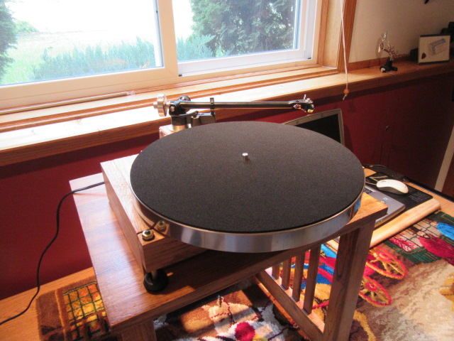

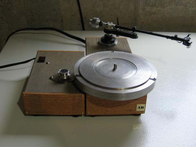

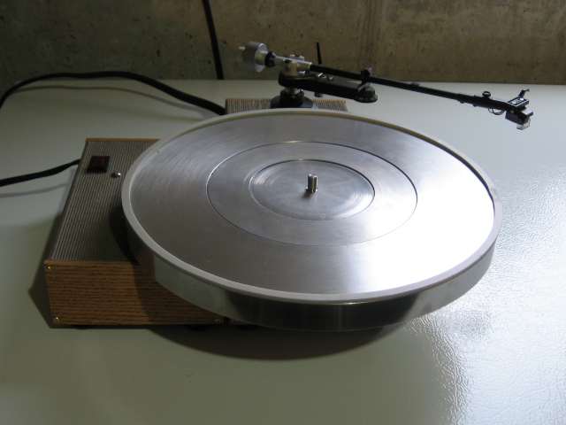

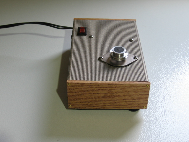

I rebuilt a plinth for about $20 for my table. The platter assembly is from an AR-XA, but I have a REGA RB300 arm on it. Separate motor in its own housing brings the noise level to very low. It is a very quiet table. You could probably do this to yours too.
Wayner

  Wayner that is really nice looking. Great job. I bet it sounds great as well. I'm impressed. I would buy that just for looks. Really got me with that TT oh my !!!  "T"Bone" baby.

Thanks guys. It's also stuffed with about 5 pounds of platiclay on the inside........
I have very limited tools here, so most everything has to be made so I can cut it with my 20 year old chop saw, and a drill press. I also have a palm sander to clean the cuts up. This table is about 5 or 6 years old and has a Hurst motor in it.

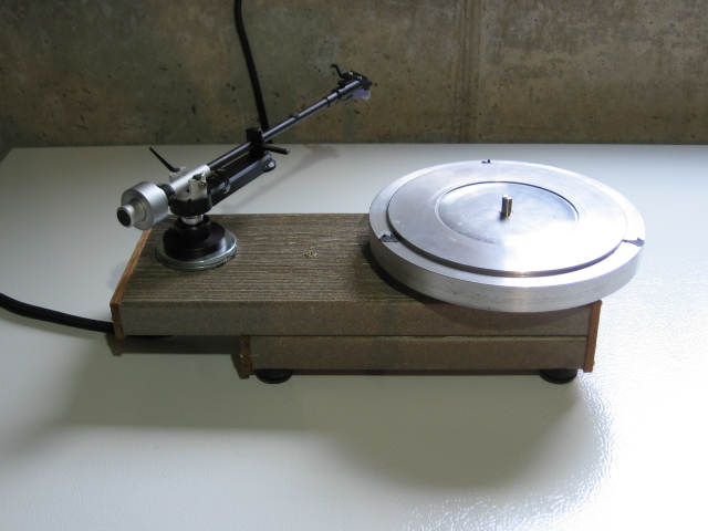

Here is another one made from composite decking material. This is extruded stuff made out of recycled plastic and what ever else they put in there. It truly is a "green" product as everything except the motor was recycled.
This one also has lots of plasticlay in the hollows of the composite decking material. You need lots of mass in the motor module as well to absorb vibrations from the motor, or it will be transmitted by the belt and mimic 60 cycle electrical hum, even tho it is by nature, purely mechanical hum.
