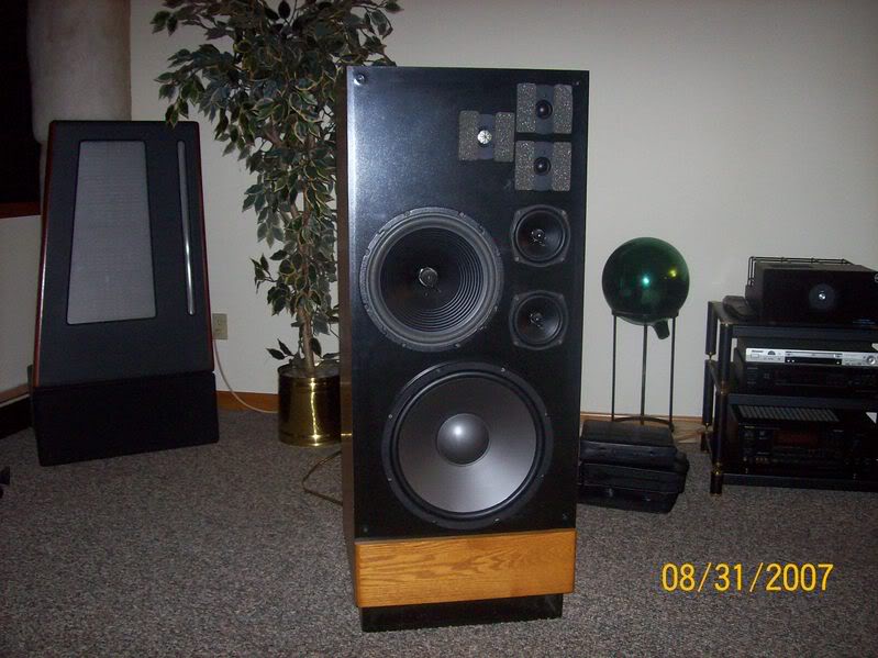

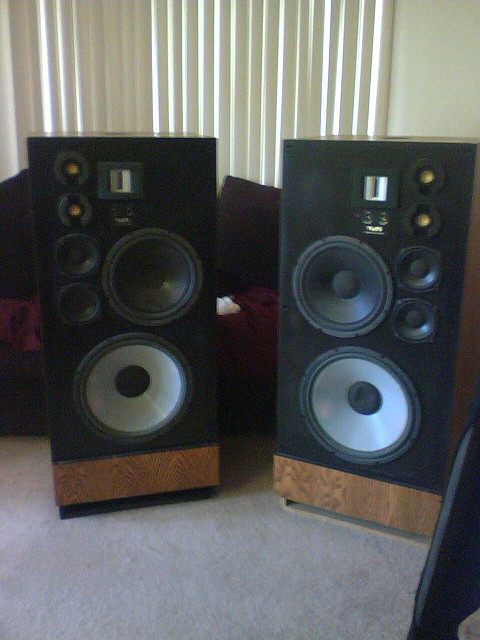

These are usually referred to as the ST/R's; the Super Tower/Ribbon model speakers.
QSO404
QSO626
And of course, they're all worth  keeping!  Maybe not worth huge money now, but I'm sure that they produce huge sound.  Still more than competitive!

I've always loved the look of VMPS speakers.  Especially, the models with an asymmetrical driver layout, with Left Right matched asymmetrical speakers.  That just looks so cool!  As such, the ST/R's have always been some of my favorite VMPS speakers visually.  Plus, there's also quite a variation among the VMPS models too; with various woofers, mids, and tweeters:
As to set up, VMPS speakers need room to breathe.  You need some distance from the speakers, to allow the various drivers to blend together, due to the 1st order in-phase series crossovers.   Also, it's not just important, but required to "pinch putty" on the down firing passive radiator, to adjust the damping of the bass, and set bass balance relative to the mid/tweeter levels.  Go here, for an explanation:
http://www.audiocircle.com/index.php?topic=30236.0
Be patient with putty pinching.  Try very small changes, adding or removing putty.  Start with the right channel speaker first, since many early analog recordings were mixed and mastered right heavy, I 'think' due to LP/album formatting requirements (to the best of my knowledge)?  Still, if they sound good, they are good.  I wouldn't worry too much about it.  But, nothing wrong with a little tweaking, to improve an already good speaker.

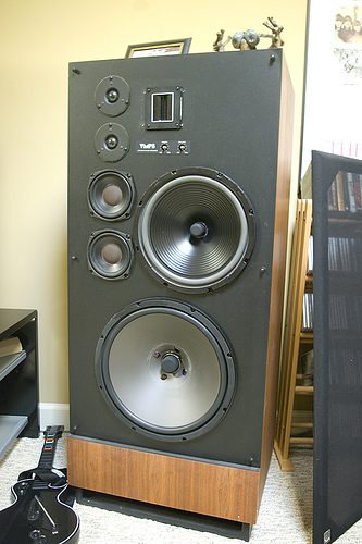

Nice speakers specially the ST/R of which I too own. When I got mine a few years back they only needed re-foaming so I shipped the 15"s and 12" to Bill LeGall at Millersound, Pa. Bill does awesome work!
When it came set-up time James who worked along side Brian on this model was invaluable for his knowledge of things VMPS, thanks again James!! James stated that Brian used a 1oz fishing sinker to start on the 15" passive. He finished by adding 4-5 inches of putty. On mine I pounded the 1oz sinker flat round and hot glued into place, adding putty directly to it, simple.
On mine I opened the bass slot to make putty loading easier and added casters for easy movement, these still run with a lot out there at 3 times their original cost, perhaps more IMHO ..... enjoy them!!
