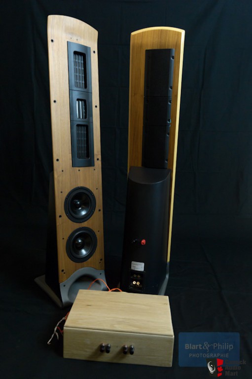

A horizontal RM40?  Something like this, but with the single ribbon tweeter?
It's be a tall center though, with 12" woofers.  But, you could mount the passive radiators on each end!
Some serious center bass!!!    :o :D :o
