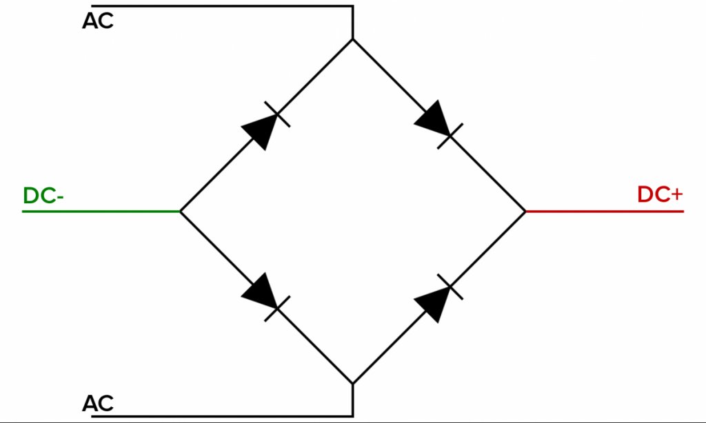

Thanks Jeff, you very efficient as ever.
If I understand right it is?
I wonder how to solder it with the legs of the square diode?

24 Aug 2015, 11:08 am »
Found a image w/other shape of Diodes.

Reply #6 on:
28 Aug 2015, 11:19 pm »
That looks right to me. If you happen to buy my parts, or similar parts, that are TO-220 packages, you may have more questions once you have the parts in hand. Let me know and we'll take it from there. Have a great weekend
