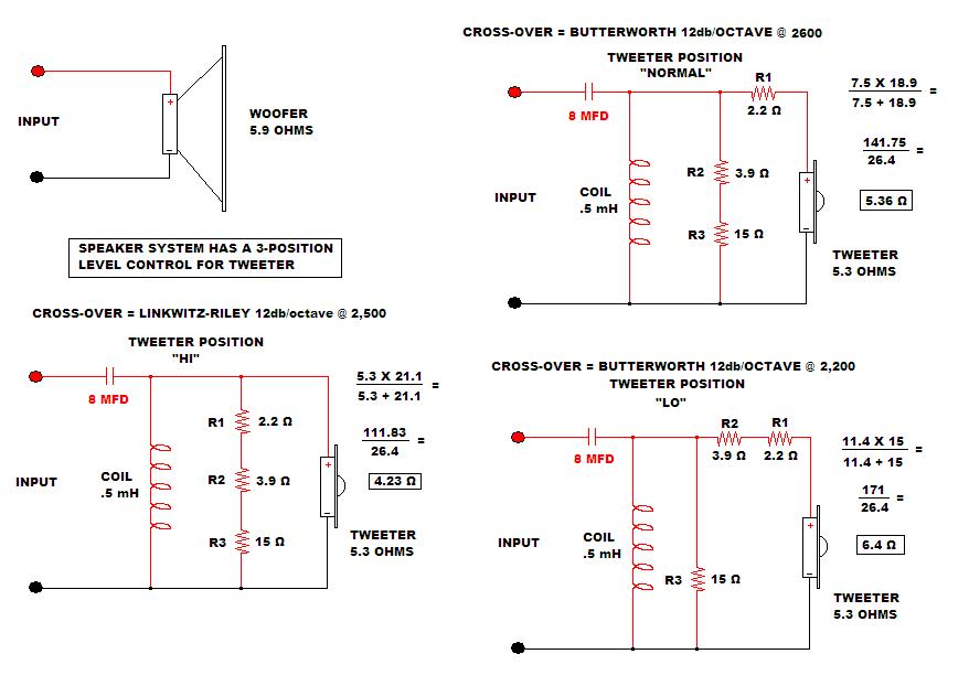

 The other day I bought an LC meter and some caps to redo my Dynaco A25XL speakers. I believe the riddle of the schematic is finally solved. The coil measures .5mh and the tweeter's resistance measures 5.3 ohms. In the full tweeter output position on the 3 position level switch, all 3 resistors are in put in parallel with the tweeter, making the total resistance of the circuit for the tweeter at apprx. 4 ohms. That fits perfectly with a Linkwitz-Riley circuit for a 2500 hz cross-over point. 8uf cap with a .5 mh coil for a 4 ohm load. The woofer has no cross-over and rolls off naturally.
Here is the math:

Oops! Slight drawing error (shame on me).
The resistor network is nothing more then an "L" pad, creating resistance in series and in parallel to reduce tweeter output. Hopefully tomorrow I can draw a real schematic and show the network with the tweeter level control in all 3 positions.

Wayner
Here it is:

Here it is:
Awesome, Wayner. Just awesome.   :bowdown:
