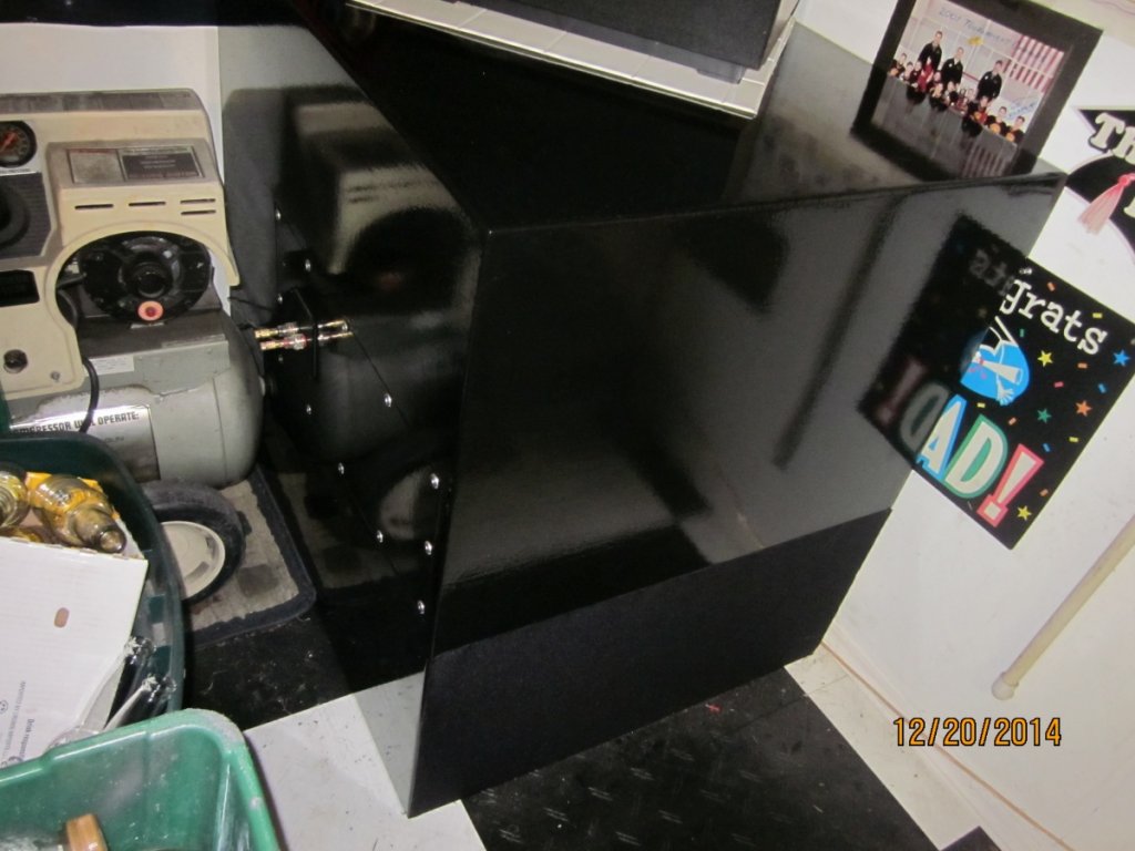

Hey Danny and Audio Circle crowd - ever hear of one of these or had the opportunity to listen to one?  It is a Bill Fitzmaurice design Tuba HT. I built one out of curiosity last winter, and it is horn loaded with a 15" RSS 390-HF-4 Dayton Woofer.  It was a involved build, but not more so that the LS-9's.   I built the 30" x 36" version, and the spouse promptly said NO WAY was it going in the house, so I jam with it in my garage (not all bad - good music, cold beer, and wrenching on cars).  For now I power it out of a receiver with an older NAD Amp.  It DOES play low, AND powerful, but curious how a horn loaded affair stacks up in the High Fidelity Arena driven with a good amp.

Heard an 8" tuba with some high efficiency speakers, sounded pretty good.

You don't have to put the box in the room, just port the throat into the room.
Like an infinite baffle.  8)

Putting woofers in a horn like that can increase their output in a range below what they would otherwise or if tuned higher they can just make a lot more SPL in a given area.
The trade off (from an audiophile standpoint) is that you have large un-braced panels that resonant pretty hard. Sometimes they become buzz boxes.
