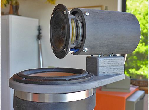

The HF driver mount is very interesting. He uses a highly damped cylindrical well with an air gap between the driver and housing.  The goal, in this case, is to properly diffuse or scatter the rear wave, to minimize the impact of reflective surfaces behind the speaker. He states that the listener's ears should be on the dipole axis.

SL opines that the rear radiation "bright spot" is the result of differing time delays between attenuated high frequencies within the tube and propagated high frequencies traveling on the exterior of the tube and there is a resultant interference when they "recombine."  Apparently it's measurable at a certain spot in distance behind the speaker, and if the microphone is moved closer (or farther away) the measurement looks better.  What you see in his measurement is worst-case.

I'd love to see the different distance measurements. One without the tube would be nice too, to see its effect. To be clear, that whole tube arrangement is what I found puzzling, not the measurements. Those were exactly what I expected.

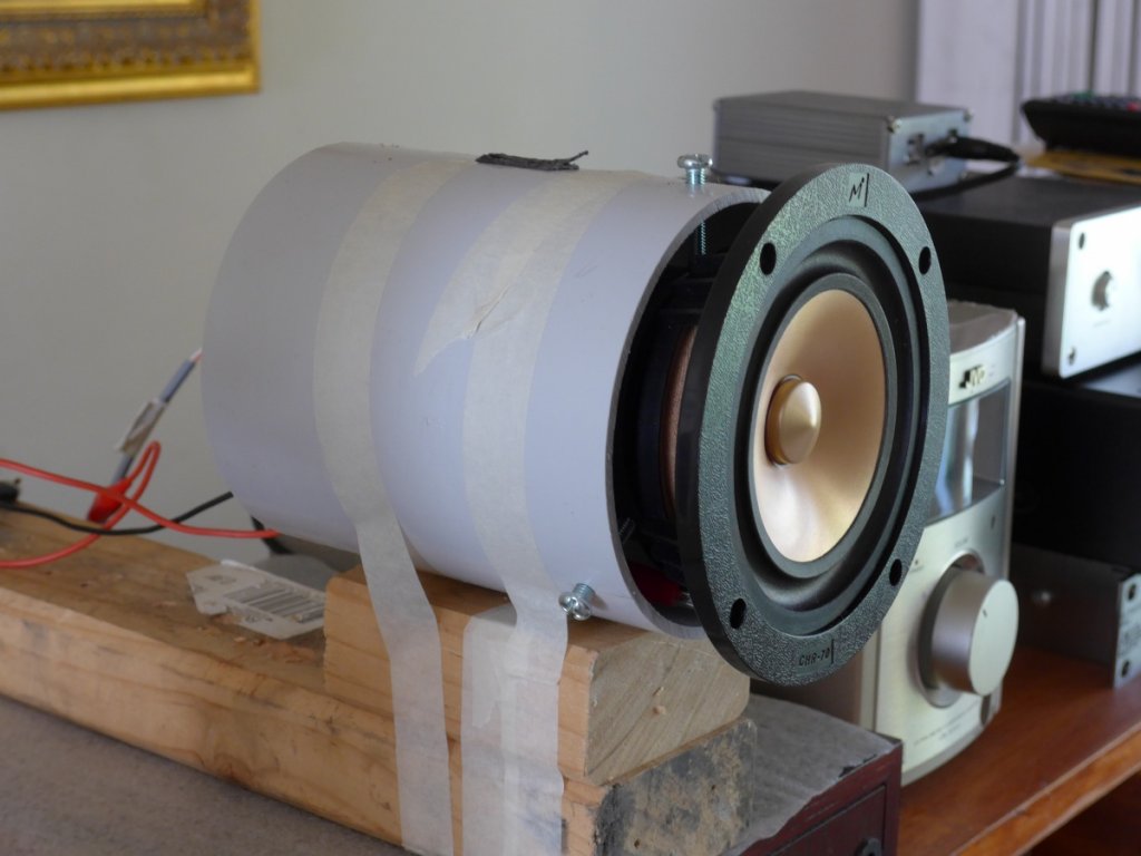

« Reply #9 on: 21 Aug 2014, 03:33 am »
Hi,
I thought some of you maybe interested in my mock up version of the LXMini. More info will follow once I have performed more testing of this setup.
It seems to work with Mark Audio CHR-70 III, the driver I am using, I am testing the top section first. The sound seems promising, very open and large sound stage for such a small speakers. BTW all the info of this speakers comes from Linkwitz's website I didn't buy the construction package.
