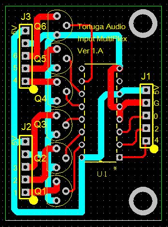

We spoke the other day regarding a LDX6 passive pre that could have 4 inputs and 2 ouputs (All RCA / Not balanced).  This would have the new LDR3x.V2 board with auto-calibration and replaceable LDR modules.
Hi Andy,
Glad you posted this since it will hopefully be of wider interest and also help me sort out the issues.
For good or ill, everything around ldr3x.V2 board was based on a 3-input concept including the V2 and the IO3 input relay board. To accommodate more than 3 inputs requires something additional that will have to be thought through.
There are 3 npn mosfet switches on the V2 that energize relays by connecting them to ground and there's no way to add more without redesigning the V2 board. However, the 3 outputs assigned to controlling those mosfets could be repurposed to act as inputs to an external 3-to-8 decoder. With 3 binary control signals you can count up to 8 so via a decoder you could switch up to 8 inputs. This would require a new additional external board with a decoder chip, up to say 6 mosfets for switching 6 input relays, and 2-3 pin headers for connecting both to the V2 board and to 2 IO3 relay boards. This would only need to be a small board that could somehow be piggybacked on one of the IO3 boards. Alternatively, I could do a slight redesign of the IO3 board to make in into IO3+3 where you could have 4, 5 or 6 inputs if you needed more than just 3.

Something like this might work. Basically it's an Input Multiplexer.
Would allow for up to 6 inputs using 2 IO3 boards. It could hang right off an IO3 board. J1 would connect via ribbon cable back to the V2 board. J2 would connect via ribbon cable to IO3A (inputs 1 thru 3) and J3 would likewise connect to IO3B (inputs 4-6).
I'll look into costs etc. This would make it possible for an updated version of the LDR3 to be customized to be an LDR4, 5 or 6 if that's what someone wanted. For this to work, the updated LDR3 would need to use the same larger enclosure that we have planned for the new LDR3B (balanced) which will be released in July.
