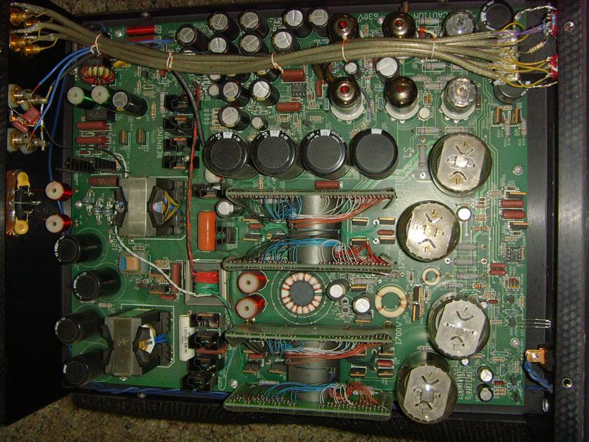

At to the Berning ZOTL, It is so unlike what we think of as an OTL that I wish he had called it something else, at least he did put a Z in front.  What we think of as an OTL does the job of sending current from the power supply to the speaker via the output tubes. Berning's amp turns the DC into high frequency current and send that to the speaker via what appears to be a HF transformer and filtering. In my understanding it is more like a switching amp than what we think of as an OTL. I think David is a very smart guy and comes up with unusual designs, how they perform I do not know.
Here is the patent. Look at the diagrams. There sure are a lot of transformers in there doing a lot of driving MOSFETS. There is a tube in there but it is surrounded by an army of solid state devices and transformers driving them at radio frequencies (RF). http://davidberning.com/technology/patent5612646
I extracted the following from the paper. http://davidberning.com/technology/zh  This is the essence of what he is doing and this is not going on in any traditional OTL amps. A very complex way to make an amplifier that would not interest me. I don't know who would be able to fix one of these other than the factory. I will continue to make things that are serviceable  by anyone with basic electrical knowledge. I am willing to work on most anything but I would pass on this.
I found this picture on Audiogon where someone was selling a ZOTL. The four tubes are to the right. The RF transformers are the thing in the center with many wires coming out. There are six small tubes top right.
The Berning ZH amplifier performs the impedance matching function of the output transformer by applying special switching power supply technology. This technology (US patent 5,612,646) uses radio-frequency to change the tube transfer characteristics from their normal impedance plane to one suitable for driving a speaker. Because the audio impedance conversion is done with an RF carrier, it is not subject to the distortions imposed by the audio output transformer as shown in fig. 3.
