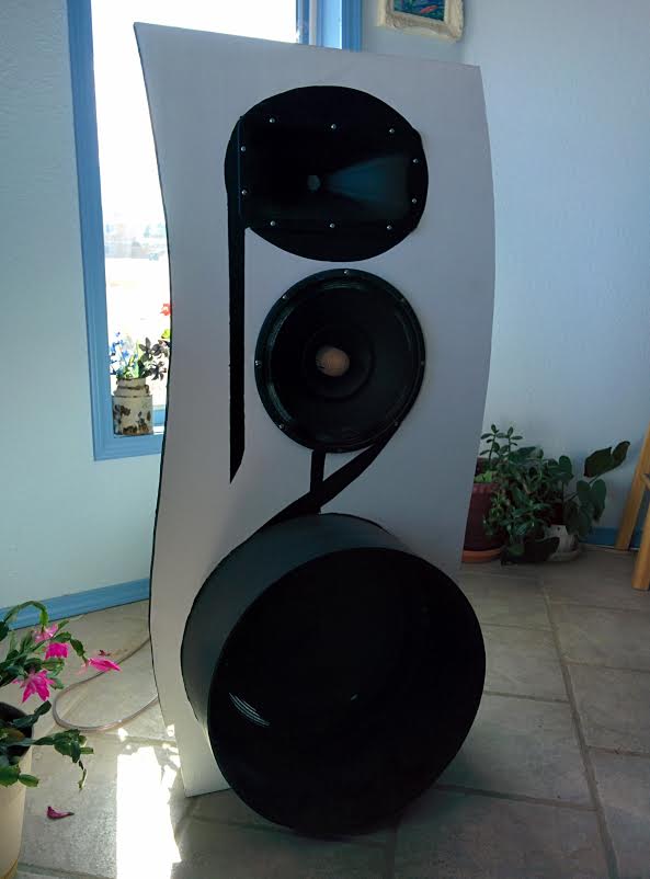

I used an 18" sonatube as aberration of Martin's H frames with Eminence Alpha 15-a. I made the length approximately the same and I figured the volume was very close. I am thrilled with them and it made it a pretty easy build. I used construction adhesive and drywall schools to mount the round plywood doughnut baffle in the tube, then attached my Alpha. these were part of an OB build using the Alpha's and 12" Betas.
I thought I could perhaps get some vinyl flooring and stick it to the sona tubes to get a nice wood look. The problem is that the tubes have a waxy coating so they release from the concrete. Glue does not stick and preglued vinyl wood flooring just falls right off.
I ended up using Elmers glue to reinforce the edges and found Latex paint sticks well so I ended up painting mine. Do they look great; well no. Do they sound great, well yes. So "sona" form followed function.
Hope this helps. They were certainly cheap as I remember 30 bucks bought enough tube to make 4 speakers. Another guy used 18 PVC pipe. The best I could find were short sections that costed well over 100 bucks. Nothing cheap about big PVC pipe but I would sure love to get some. The guy that did the PVC said he contacted Martin and Martin said the round forms should work fine. However, that is a second hand statement by me so I cannot vouch for it's accuracy. I do like the sound of mine and intend to do a similar build using a larger sona tube and Martin's larger build. I guess I liked it enough to keep doing it.

Sona Tube build modeled roughly after poultrygeist build.
