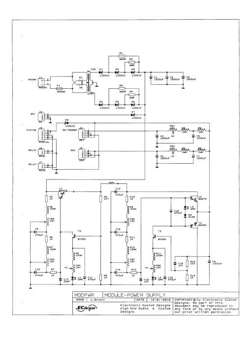

jkeny
  • Posts: 251
    • Modified Hiface USB Transports
Re: Paul Hynes Power Supplies
« Reply #44 on: 16 Feb 2010, 09:55 pm »
Hi Paul,
You may have seen this post on DIYA from -ecdesigns- http://www.diyaudio.com/forums/digital-source/140538-lossless-sd-card-player-43.html#post2087091 where he has presented a solution for the switching noise usually found on normally rectified power supplies. Have you any comments on the efficacy of this approach? I'm thinking of using it as the PS to feed your regulators. I know they have high PSRR but even so, cleaner supply helps even with high PSRR.
This is what he says:
The stepped rectifiers greatly reduce switching noise as they switch-on and off in stages. Single rectifier goes into full conduction after transformer voltage exceeds reservoir cap voltage plus diode voltage drop, and switches-off immediately (risk of back emf and oscillations) when transformer voltage drops below reservoir cap voltage plus diode voltage drop.
3-stage stepped rectifier starts with low charge current (series resistor #1, one diode conducts, step1), then increases charge current (series resistor #2, two diodes conduct, step 2), finally it provides full charge current (3 diodes conduct, step 3). Switching-off goes in reverse order, reduced charge current (2 diodes conduct, one is switched-off, step #2), lowest charge current (one diode conducts, two diodes are switched off, step #1), then it switches-off completely.
I use diode threshold voltage in combination with bypass resistors to achieve this (resistor already provides charge current when the diode is not yet conducting). One diode is not bypassed with a resistor, making sure current cannot flow in reverse direction.
Paul Hynes
  • Posts: 373
    • http://www.paulhynesdesign.com
« Reply #45 on: 17 Feb 2010, 10:16 am »
Hi John,
This is an interesting idea that may offer a useful and relatively inexpensive reduction of diode switching noise. As I have not tried this I cannot say how effective it would be. Perhaps you could try this out and give some feedback regarding how effective it is. I would have a look at it myself only I am very busy catching up with orders at the moment.
