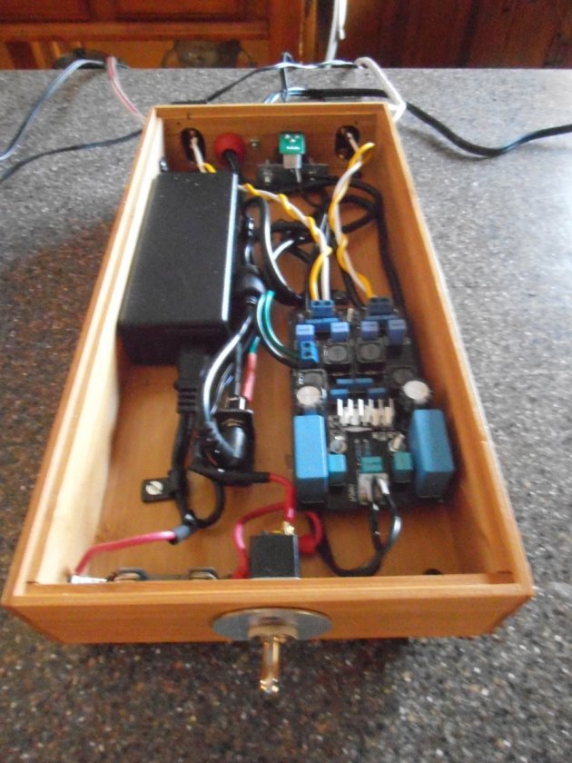

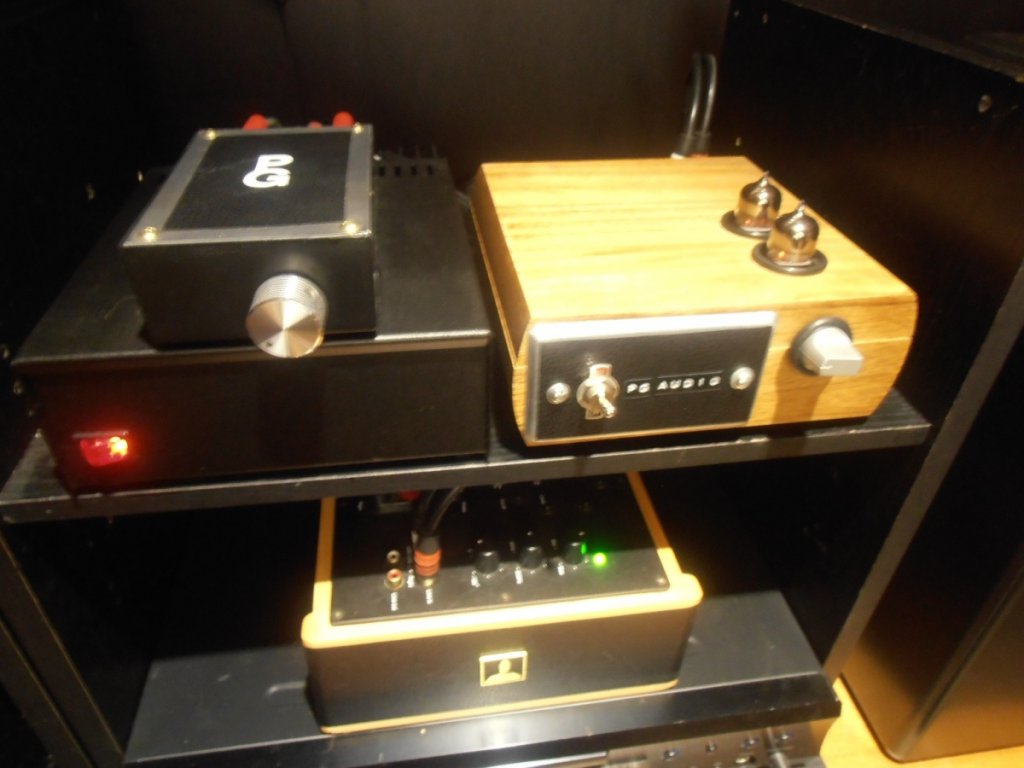

I'm crazy about the $37 Sain Smart 6n3 tube preamp from Amazon with my Astron powered dual chip TPA3116.
Poultrygeist
The Chinese tubes sounded better than expected but I went ahead and replaced them with 6n3p-ev Russians.
Poultrygeist

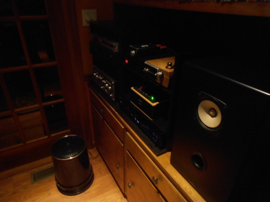

FWIW I get little to no on/off pop with the dual chip 3116. It's about the same as my Audiobah green board. My bookshelf system includes Tekton Fostex full range single driver speakers and plate amp driven bucket subs. The Sain Smart sounds better than my 3 tube 6n3 and is a better match for my current system.
Poultrygeist
I have the YJ blue/black board pictured here and compared to the others it's not one of favorites. The new dual chip is at the top of my list followed by the Audiobah green board and Sure TPA3110. The pop is bad on the YJ blue/black but horrible on the Sure TPA3116 which I don't think PE sells anymore.
I thought at first the volume control on the dual chip might be an issue as I knew I wanted to use a tube preamp but it's not at all. I just max it and control the volume with the preamp. I no longer use the lap top power bricks as the 12v regulated PSU's sound best to me.

Awesome casework PG. Love the top that opens. Your system looks great to me.
