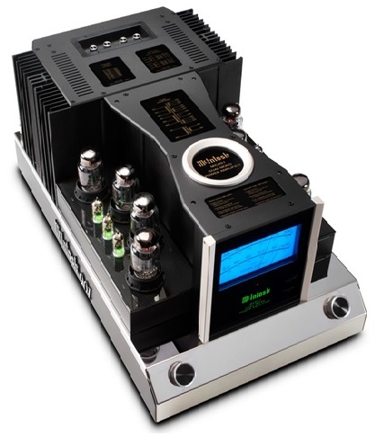

The McIntosh MC901 works well for vertical biamping with a 300W tube output and a 600W solid state output.
The best of both worlds ..... at a price!  ;)
