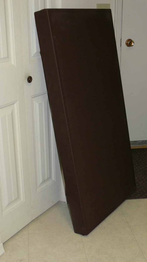

I finished the panels yesterday.   Haven't got them hung yet  but  even just placing them   at the first reflection points they seem  to make quite a difference
Here is apic of one of them, I alreay  had  a bunch of stone wool (safe & sound)here so I just used that. When I do the bass traps for the corners,  I'll  buy some of the semi rigid FB from HD  as  was posted above and make them  4.5"  thick.  I ended up using brown gill cloth which matches my couch quite necely.
There is few more pics in my gallery if interested
Thanks for the help everyone
