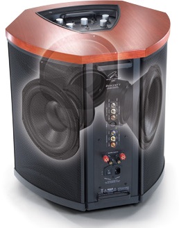

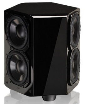

OK, thanks Danny, I was thinking more about box shape regarding what side to put them on and wondering if there is a disadvantage to facing them different directions?
It would be a more difficult box build, but I think it might be interesting to put them in an hexagonal enlosure with a force-cancelling 120 degrees spacing ala Martin Logan Depth i/Descent i or Paradigm Sub 1/Sub 2.  Because they would be sealed without a sound eminating port, it would seem it might vary the propogation of bass waves a bit - but more importantly they would look pretty cool!

It would be a more difficult box build, but I think it might be interesting to put them in an hexagonal enclosure with a force-cancelling 120 degrees spacing ala Martin Logan Depth i/Descent i or Paradigm Sub 1/Sub 2.  Because they would be sealed without a sound eminating port, it would seem it might vary the propogation of bass waves a bit - but more importantly they would look pretty cool!
Steve
Steve,
Those do look really cool, so it looks like I shouldn't have a problem putting the sub drivers on different sides of the box. I'm looking at a rectangular low profile shape that would sit below a stand mounted mtm design.
