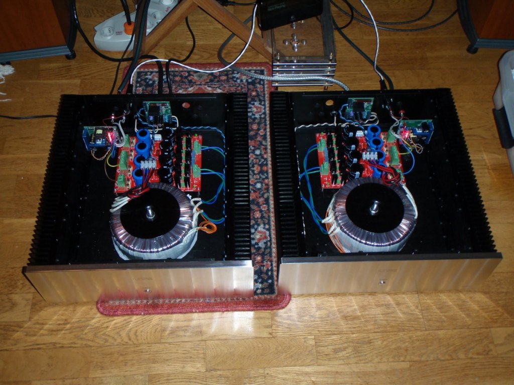

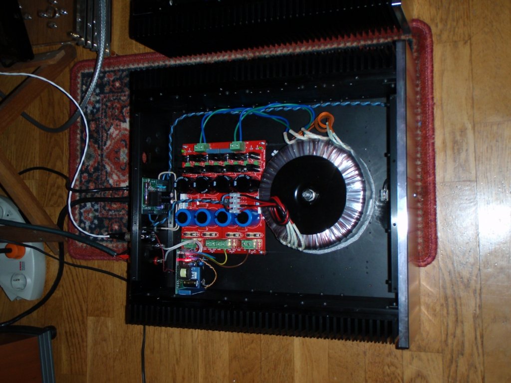

« Reply #9 on: 20 Mar 2014, 08:27 am »
Nothing like a good linear PSU ;-)
2 x 42V - 1500VA Trafo & 80 000 + uF  (mono-block)
