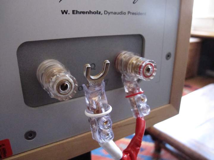

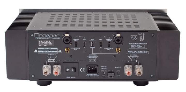

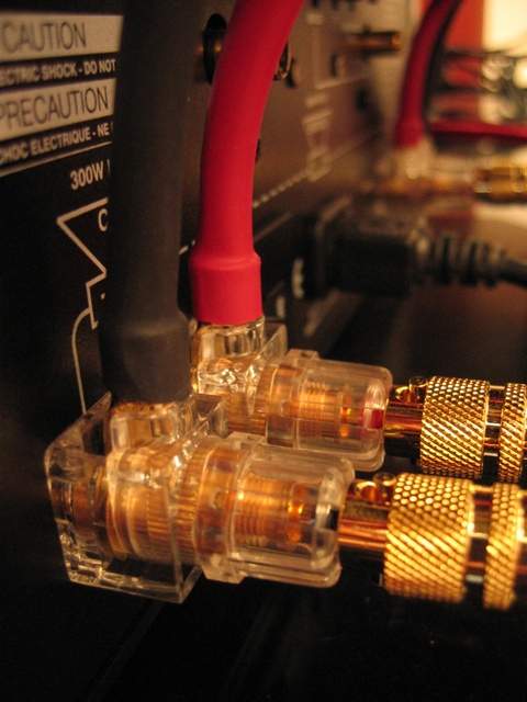

These plastic housings are driving me mad because I cannot insert my spades all the way.
http://www.audiocircle.com/image.php?id=25655
As you can see in this picture the plastic lip on the top is causing the interference, even with large flat (not angled) spades.   You can imagine with angled Cardas spades it is much worse.
Can the binding posts easily be changed, or does the cutout on the chassis require these exact posts?
If not I may have to cut off that lip.  :evil:

i was using cardas spades at first on my 4bsst2 but found they were not making a solid connection. so i went with cardas bananas on the amp side and they seem to be working good. also i'm using the spades on my Salk ht2-tl's as you can tighten them with a wrench (just don't over do it)

The posts need to be redesigned. Whoever heard of designing a post that doesn't accept all spades. Spades have the largest contact area so if they fit, as they should, make the best connection.  My big spades on my Transparent Reference speaker cable barely fit. and then it is extra difficult to tighten the posts with a quarter (recommended by Bryston)

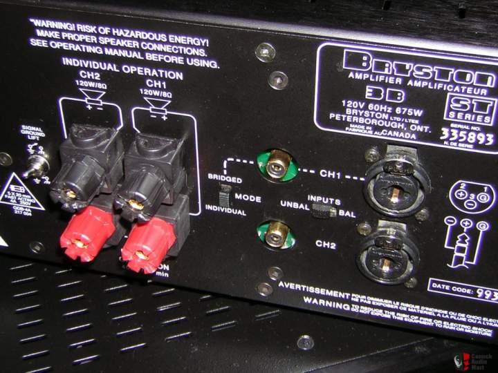

Are these housings different from those in the discontinued ST series?
I can insert VDH SB-10 angled spades all the way in my 4B ST - would be most grateful if anyone here will let me know is some form-factor change has been done to the housings in the SST2 series. The ST housings have lips too.

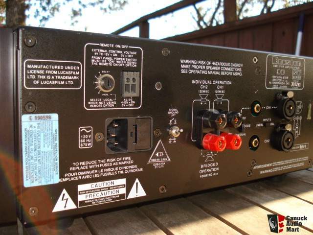

rob80b
Re: SST2 binding posts
« Reply #6 on: 16 Jul 2012, 01:44 am »
Are these housings different from those in the discontinued ST series?...........
...........So, aside of its translucent look, are the housings in the SST2 different from those in the ST series?
 :o
Depends on which ST, the earlier models had no shroud around the post, the newer ones were introduced in 1999.
prior to 1999
late ST
The SST/SST2 may have clear or colored (black & red) and are very similar to the later STs, neither will accommodate my WBT spades, on my previous Audioquest cables I had installed Brystons original large spades and they fit like a glove now I'm using bare wire also at the amp end.

I use Bryston's larger spades on the amp side with my sst's and 28's and they fit perfectly.
They have the shroud or lip on  there also.
Use to use Cardas GRC's but they didn't fit well at all and I don't even miss them.

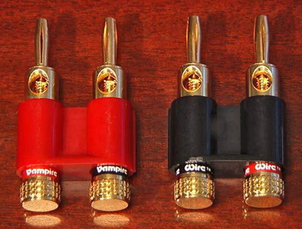

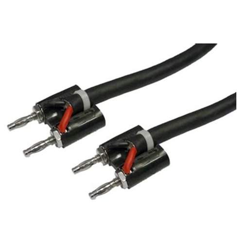

For safety reasons the plastic shrouds have been required by law for quite a few years now for products sold in Europe, and most importantly the spacing of the binding posts which once accommodated the dual banana plugs
also had to be changed so that they do not accommodate these.

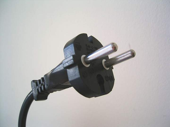

« Reply #10 on: 18 Jul 2012, 04:18 pm »
Robert,
The img posted above shows a Schuko which does not have earth contacts.
My 4B ST came with one of these:
I expect my new SST2 will come with the same earthed Schuko.
I'm somehow biased towards these German / French plugs, I think they're better than those used in North America, but I may be wrong.
Obviously, for 220 - 240 line voltage, up to 125 A.
Fernando.

Sorry too many pictures, so to summarize; the EU banned the traditional dual banana plugs/sockets that were widely used on many amps and speakers because they fit some of the 230 volt wall sockets and the shrouds were also required by law to reduce shorting speaker connections.Thus if a manufacturer wants to distribute their equipment in the EU they need to abide by the law, unfortunately a lot of  spades/sockets especially from north America never followed suite or manufactures designed their own and are sometimes incompatible when mixed with other designs, like my WBTs for example.

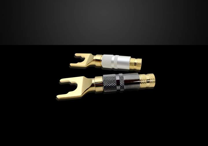

Are those old Bryston spades still available somewhere?  I mean the longer one on the left - no way the one on the right will seat fully.
The new ones look too generic to be made by Bryston.
James Tanner
  • Posts: 21006
  • The Demo is Everything!
    • http://www.bryston.com
« Reply #16 on: 19 Jul 2012, 02:27 pm »
Are those old Bryston spades still available somewhere?  I mean the longer one on the left - no way the one on the right will fit.
No I am sorry the older ones are no longer available.
