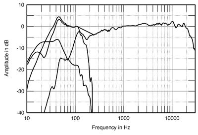

look at the measured frequency response plot of your speakers, according to s'phile.  large peak - ~5db - right about 40-50hz.  mebbe it would be beneficial to use your xm9m w/your subs, set at 50hz, and w/the damping pot turned down...   :scratch:

it's not that the size of the speakers themselves are too big - it's the size of their bass bump at 50hz that is too big...

might be worth a try; according to s'phile, the port also has a peak at ~50hz.
