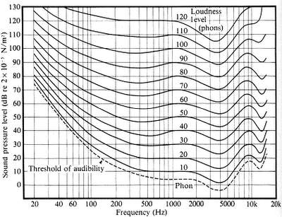

I don't think your issue of bass response at low volume levels has anything to do with the room, your receiver or your speakers for that matter.  What you are experiencing is due primarily to the nature of human hearing.
Fletcher and Munson conducted a number of studies and in 1937 published their findings.  While their initial work was refined over the years by others, their basic findings were confirmed: Human hearing is less sensitive to low frequencies as volume is reduced.  Here is a graph that shows the relationship between volume (SPL) and human hearing sensitivity.
In the '70's, some amp manufacturers installed "loudness contour" circuits in amps.  When the circuit was engaged, the amp boosted low frequencies at low volumes to compensate for the "Fletcher/Munson effect."  I don't see these circuits being used much today, but the effect remains.
People often ask which of our speakers performs best at low volumes.  I always need to explain that our speakers perform quite well at all volumes, but no speaker can overcome this aspect of human hearing.  And no amp without a loudness contour circuit can either.  Human hearing simply isn't very sensitive to low frequencies at low volume.  As a side note, humans generally cannot localize sounds under about 150Hz or so either.  That is why you can generally place a subwoofer just about anywhere in the room and you won't be able to tell exactly where the low frequencies are coming from (other than the fact that it may pressurize the room differently).

phoward, what you need is old fashioned "loudness control" that compensates for the Fletcher-Munson effect.  Audio purist drove that and tone controls into extinction decades ago.  The problem with loudness controls is that to work right it has to assume room size and speaker efficiency.  And as I posted above, EQ (like my 31 band Behringer) is the best way, with vinyl in the mix, to tweak frequency response (it is a revelation to hear flat frequency response).  But again, EQ should only be applied after proper setup and room treatments.
