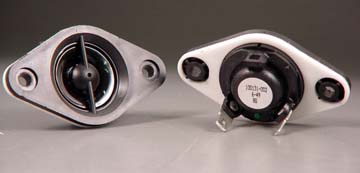

The usual suspects are small horns, FT17, FT96, T90. If you can find some Radio Shack "tweeter pods" they have some nice little horns i rank a bit above FT17 (especially if you get older ones with Al horns -- i have lots of the plastic horned ones). You might get away with some of the cheap horns, the pair of Goldwoods i got need to be disassembled and the plastic mouldings detailed at a minimum.People have also been using domes (ie ERT26) or ribbons, bit they will have alarger dispersion flare at the bottom of their passband (i guess you could waveguide load the appropriate dome)dave
