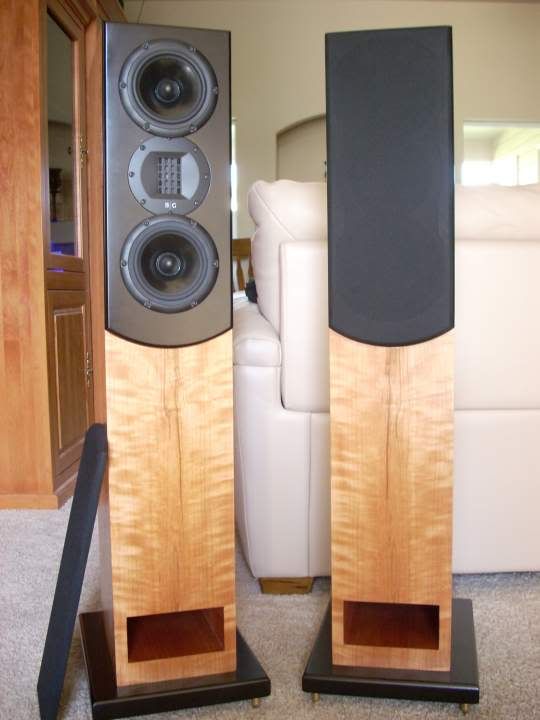

You take all of the bracing that makes the TL and flip flop them all to make the exit out the front. Or you could look at it as flip flopping all of the drivers to the other side of the box. Same thing...
So the top baffle which is currently under the lower driver would now be on the opposite/back side in relation to the lower driver?
Danny Richie
Re: Matching surrounds to N3S Speakers
« Reply #21 on: 30 Sep 2011, 03:54 pm »
If you are looking at the first page of cabinet plans (via the web site), then instead of the drivers mounting on the left side of the box (side profile), they are mounted on the right side of the box.
Brace A (at the top of the box) moves to the other side as well.
You also move the tube connectors to the opposite side of the box too.

Looks like this when done! :thumb:

Some have even made a little grill (grill cloth) to fit over the opening.
And here's an example of that. :thumb:

« Reply #25 on: 4 Oct 2011, 03:24 am »
Ruben,
Is this your handiwork?
[/quote]
Outofthewoods
  • Posts: 980
  • Fallen Enclosures, Inc. Crafted with Passion
« Reply #26 on: 4 Oct 2011, 03:33 am »
Ruben,
It isn't.
I can't remember who it was that built those ones. :scratch:
Ruben
