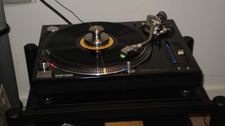

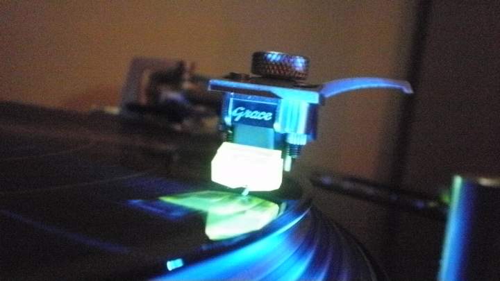

So far sounds pretty good, couple of pics
http://www.audiocircle.com/image.php?id=50007
Grace F9E Looks cool when lit up, it has a flourescent stylus, never knew that
until I put it on this table.
http://www.audiocircle.com/image.php?id=50006

Looking good  :thumb:
Will be interested to read your impressions with different carts.  I started with the Ortofon 2m blue, then came upon a Soundsmith Boheme and stopped there.
Saw in your systems link you are/were running a VPI Scout with Trans-Fi T3 ProTonearm... pretty serious kit there IMO ... have you replaced; if not can / will you offer a comparison when things settle in?  Although pleased with what I hear, my mind is always pondering alternatives.
