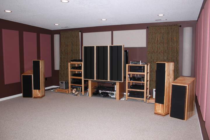

Pictures would be nice if possible.  8)

That'll work.  :thumb:

ZOINKS!
Looks Fabulous Frank... What a room!

SWEET!! > Can only imagine how awesome it sounds :o

very nice! :thumb:

Very nice Frank :thumb:
Thanks for sharing your initial thoughts and impressions. Looking forward to additional posts.

As is often the case, finding the best position for subs was the first priority. What I was looking for was an absence of room modes in the bass and a coherent and stable soundstage where the radiation from the main speakers wasn't effected by the presence of the subs, which are very large. I started out with them side by side and eventaully have settled on a position where the front face of the two boxes are about 10" from one another, with the subs next to Ulysses. The picture Lou posted of my room is accurate, except that the subs are now a bit further back.
I have settled on connecting the subs out of phase with this placement and use the Marchand to dial in the volume of the subs. The Marchand has a cool featrure which lets you sum the bass, which has a stable effect on imaging and increases the dynamic impact of the bass, but without any overhang. Using the Marchand this way, the volume of the bass increases, which can then be controlled with the gain controls on the Marchand. I've got the Marchand gain set at a low level this way.
