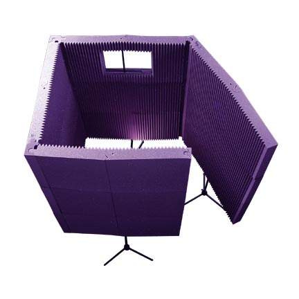

But anyhow, after all the aforementioned chatter, I came across a couple commercial products that can be used to create such a chamber.
They are actually designed to be used for recording studio environments to keep the recording pure.  Well you can use them in reverse.
Here is what they look like, and all you do is add any additional materials you might need to hit any additional band of frequencies you want.  In the upper version you would take the frontal wall/door and place it across the top.

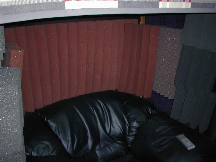

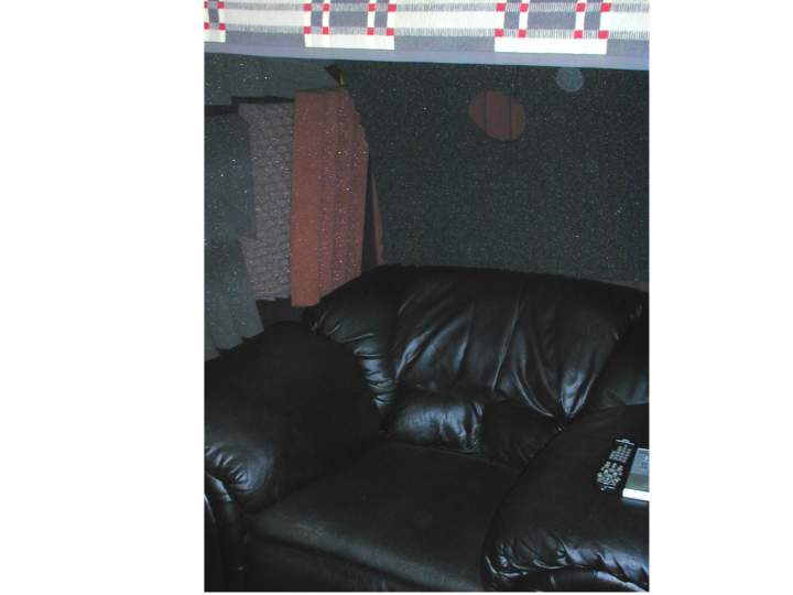

And a couple shots of the real listening chamber

Scary looking there John.  :lol:
Where do guest(s) sit?
Depends on if they are male or female. :green:
Really the "listening chamber" is for High Performance Listening much like a Formula One Racer is for High Performance Racing.
If you want to take on passengers you get an M3 Bimmer and sacrifice a little performance.

Yes the HOOD and the LAPEL tweaks, while looking a bit strange do just that.

The broadness of the band of frequencies this affects will be determined by the materials used.
In the pictured chambers you see two different approaches.
1) The Auralex (purple) unit uses exceptional thick and dense closed cell foam.  This will not reach really deep, but is effective for a pretty broad band.
2) The second pic shows a more solid (I don't know the material) wall structure with acoustic foam inside lining.
I have used large cardboard shipping cartons (very dense) packed with old clothing, bedding and rags, as well as some of the shipping packing materials.  These then are covered with high density foam, then wedge and egg crate foam, high density moving blankets/pads and regular wool blankets.
This combination of densities along with substantial front wall treatment do an outstanding job.  The Sonic Hologram is pretty startling.
As I mentioned earlier, I have also used spare matresses and box springs that did a rather good job in combination with additional materials.
It is not unlike squeezing the last bit of "light" out of your HT room.
Contrary to the opinion of many, it does NOT damp out the high frequencies, it makes them much more clear and distinct.  You will hear detail you never knew existed in good recordings, because the ROOM Distortion (reflected sound NOT from the speaker) obfuscates it. :nono:
