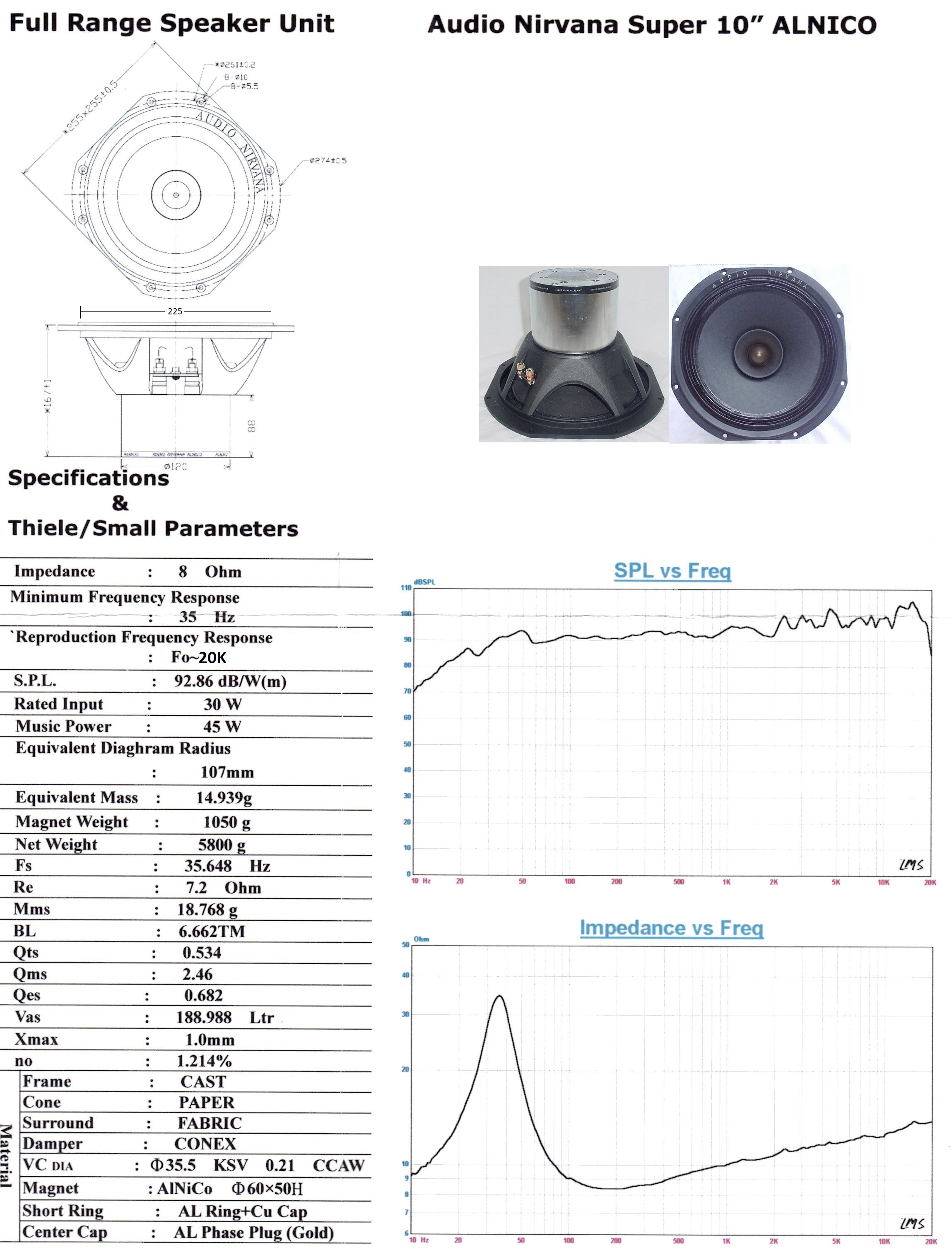

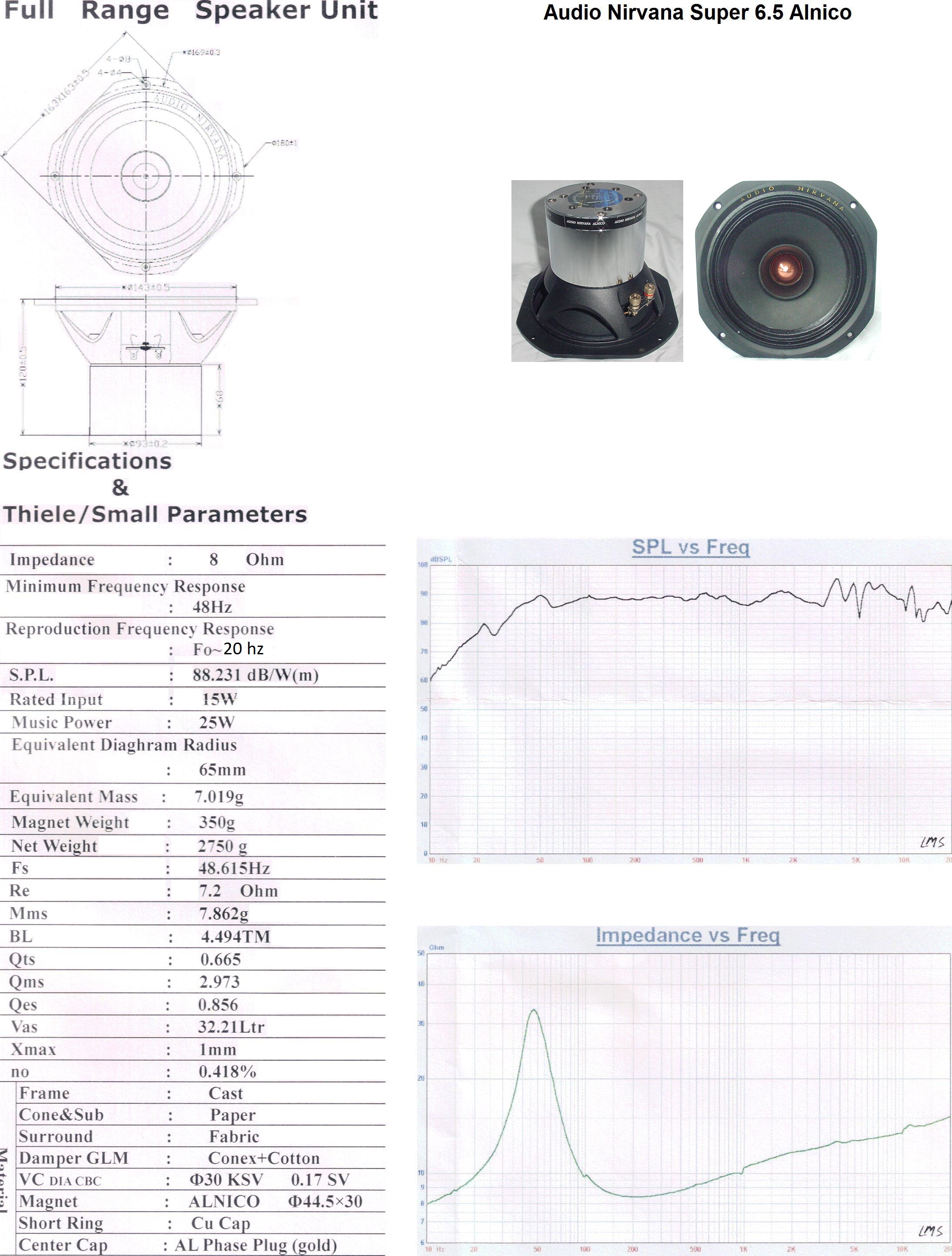

  • Audio Nirvana Super 8 Alnico (8 ohm).
    • Variants/comments: high Qts indicates open-baffle use; similar drivers in different sizes: 6" and 10". Note that some online reports question T/S accuracy, probably not really an issue for likely open-baffle usage.
    • Frequency response: 45 Hz infinite baffle (Qts=0.73)
    • Nominal efficiency: 90.6 dB/W/m
    • Additional information:
    • Approx price: USD250; (USD640 per pair inc shipping to Australia)

8" -- Fostex FE206En, FE208eS, 3 different Audio Nirvana, TB W8-1772
10", 12" -- Audio Nirvana

Added Audio Nirvana Super 8 Alnico (is this really an 8" or did I miss something - I calculated Sd of only 186 cm2 based on 77mm effective radius?)
