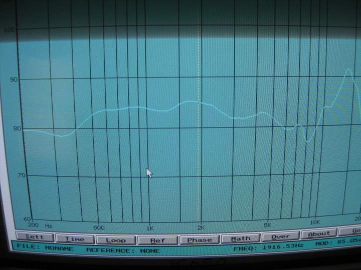

Not really.  They are 9mm Al Taiwan drivers that we got from Dave Elledge. They seem to be reasonably well made, with rubber surrounds and hefty magnet structures.  I measured it with a dos based Clio and can't seem to transfer files.  I'll take a digital photo of the screen and post it.

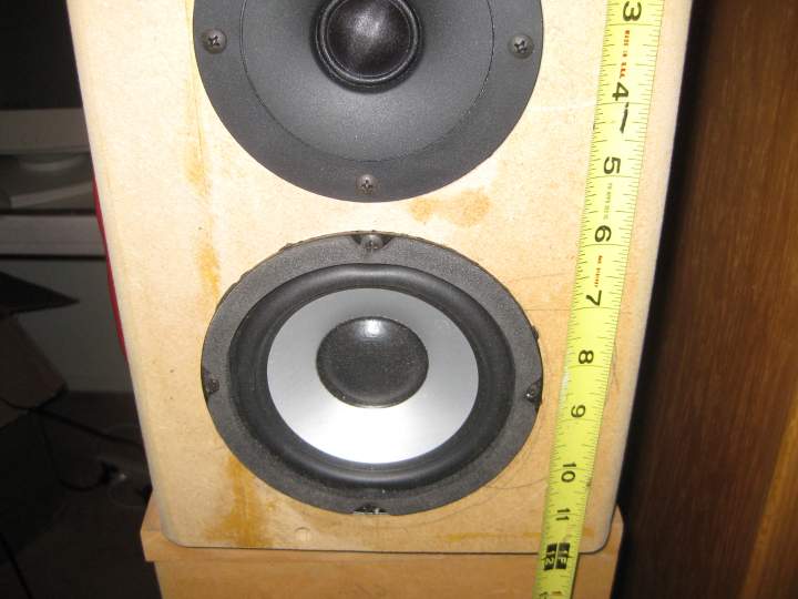

Ok, here is a screen shot and a photo of the driver.
I've definitely seen worse breakups in aluminum drivers. Fairly flat through the baffle step loss.   Not bad.
Here it is in a test box.

Just a thought, but when measuring it, are you setting it on a box like the one in the photo? If so it will add to the baffle size and give it a little lift in the 500 to 600Hz range.
Looks like the break up is pretty high on that one so that will really help.
I also know that tweeter can be crossed pretty low.
So crossing it in the 2kHz to 2.5kHz range with a second order crossover might be pretty easy.
S Clark
  • Posts: 7565
Yep, that is exactly what I did.  Should I try to create an adjustable setup like yours?  How severe a lift are we talking about? 3 dB?
Danny Richie
  • Industry Contributor
  • Posts: 14660
    • http://www.gr-research.com
I bought the stand I use from Parts Express.
I bet it is at least 1.5db in that range. I'll let you tell me how much it is.  :D
