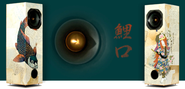

Forget the 15" coax, Look at these cabinets.  :o :o :o :o
Unbelievably beautiful!
The things you find when you're insomniac and awake at 5am.

Had a good experience with David too.  Those painted cabinets above ARE cool!
