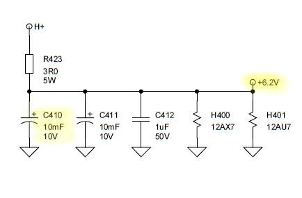

Ok jim i need clarification is c 410 47 uf 450v? or as the manuel says 10000 uf 10v?
I see the traces that go into that cap have a value of 295 v.
This makes it 47 uf 450v right just like the pic on this site?
Are there any other mistakes?

Yes i read that in the manuel.i also went to a site on building the chime and it specificaly says that that c410 is a 47 uf 450v cap.It has a pic and it labels it.
That's not been my only problem.The transformer that mounts to the underside of the board mounts one way.On this same site it says don't trust the label on the transformer to show you the way to mount the transformer. it's written 1 2 3 4 on the under side.This is mounted to the front.
On mine the label is mounted backwards.So i have that transformer in backwards lol!Or should i say dam it!
So there is my problem.
So i will pull it then try 10000 as their already in.If that does not work i'll try 47.
I have a feeling it's 47.
wHAT A PITA.
tHESE INSTRUCTIONS SHOULD BE RE WRITTEN IN MORE DETAIL!!!!

I think that if you read the article "Building a Chime or Two" it is very clear explaining the mistake. There are two C410's----one is in the filament supply and that is low voltage 10,000 uf and the other is high voltage 450 volts. By process of elimination you should get them in the right place. However, if you read the parts list it clearly shows which cap goes where.

Relax----if you will install the caps per the picture on the "Building a Chime or Two" it will be correct.

I think the PCB silkscreen has an error with two C410 on it.  I forget.  Follow this photo, the larger diameter caps ar the 47uF 450V.
