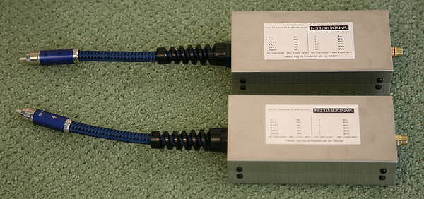

I know you want to build these hi-pass filters, but what are describing is exactly what Vandersteen sells (and requires) for some of his speakers.
To handle the different impedances, these filters have dip switches that allow one to match the hi-pass filter to the amp being used.
Also, the hi-pass filters use a battery bias.
They come up from time to time on Audiogon in both xlr and rca versions.
Here is a picture:
