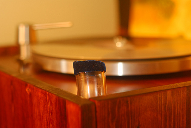

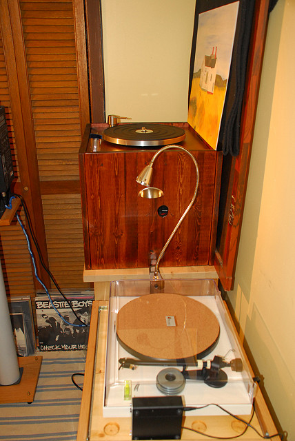

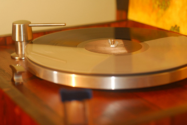

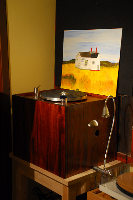

Well It is final done. I completed my first DIY Record Cleaning Machine yesterday and it turned out pretty good IMO. I originally started to mimic VPI's Record cleaning machine looking at various designs on the net. I will try to explain what I did the best I can with out going into too much detail. Over all this was not too hard, though it did take planning, patients and a bit of R& D to get it right.
MATERIALS -
Small Shop Vac $40
Wood ( I broke a piece so I had to buy another.....stillhave more) about - $40
Stain (have some left over) - $5.50
Clear Coat (have some left over) - $7
Small DC Motor - $7.50
Velvet Ribbon - $4
Hose - $6 (have some left over)
Various plumbing Part - about $4(have some left over)
Switch - $2
Hardware/Brackets/handles/etc (have a lot left over) - $15
Soap Dispenser - $19
Approx Total = $150
Please note I did not skimp on materials, this can be done a lot cheaper
Now that the cost is out of the way I will move onto REALLY VAGUE and BASIC construction description.
First I built a box to the spec of my Vac. After I built the box I realized I could have built it smaller yet change the design of the machine a bit. Oh well it is HUGE I know, but it works and I still like it.
I then cut the appropriate size holes for the switch, turn table, hoses, exhaust and cables. Staining and making sure the box was correct was the most time consuming part of the project. I stained the box with 2 coats on the inside and outside.

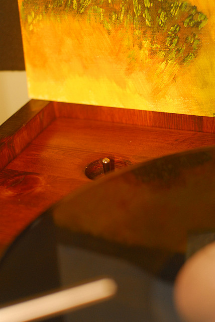

I then fixed the motor to the top of the RCM.

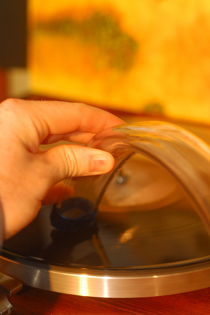

MOst Challenging:........... attaching platter to motor.......................
......................................I decided on industrial Strength Velcro, this worked perfectly and was more than strong enough. This portion of the build kept me thinking due to the shape of the platter bottom. Some spacers (washers) had to be glued together then glued to the bottom of the platter. The height had to be perfect as well.
Another challenge was the stability of the Platter. Stopping it from wobbling during force is key. Using washersamd automotive glue I made the platter Float and skim across the top piece of wood of the RCM. To take stress off the motor I glued Velvet to the bottom of the Platter so it will glide as it spins.
Originally I had a suction wand like the VPI but it didn't work very well, the current design works pretty Damn good. This machines Turntable goes forward and Backwards like the VPI and is NOT too Loud. I was thinking of adding some sound dampening material inside the box to cut some noise.

I just picked up your turntable light for $10 at a building supply store last week.They are used as an outdoor grill cooking light but the clamp locks on to my 2 inch cherry wonderfully and the 2 foot adjustable neck is trick also. Best $10 ever spent on illumination. :thumb:
guest48077
  • Guest
Re: It is done !.....DIY Record Cleaning Machines
« Reply #15 on: 5 Aug 2009, 09:45 pm »
Well you got a pretty good deal. I paid 22 bucks for mine. It is also a BBQ out door LED Light. I like it for record cleaning, it really shows the dust(befor Cleaning of course.

Well I figure I should supply an update to anyone who is interested. It has been afew weeks now since I complete My Record Cleaning Machine.
The results of this DIY Project is a complete success. I made some Record Cleaner (thanks Wayner, I followed your recipe from the thread). Wayners recipe was cheap, simple and effective (this is my first experience with record cleaner BTW).
I encourage anyone with a little DIY/ Building Know how to make a Record cleaning Machine instead of buying............ It really works wonders with the sound of your vinyl.
