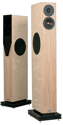

Demarche
Re: Side Firing woofers
« Reply #10 on: 15 Nov 2008, 06:39 pm »
Cool! This is great stuff. So, it sounds like from what folks are posting is that these style speakers may not be anymore difficult to place than your typical front firing style. But of course there is no hard and fast rule here, as the cross-over and the room still play a big part. There may be some improvement on the imaging because of the narrower front baffle.
I don't have a standard room shape, so I was curious as to how these types of speakers might be more or less difficult to place in this room.
Demarche
« Reply #11 on: 15 Nov 2008, 06:44 pm »
This might be easier to see
