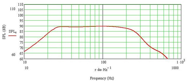

I would like to point to my thread below about MJK's Bass Study: http://www.quarter-wave.com/OBs/U_and_H_Frames.pdf .
According to MJK's simulation models two Sonavoxes in an H-baffle double the heigth of MJK's and same width would produce like this with 125 Hz LP L-R /12dB/oct filter:
/Erling
