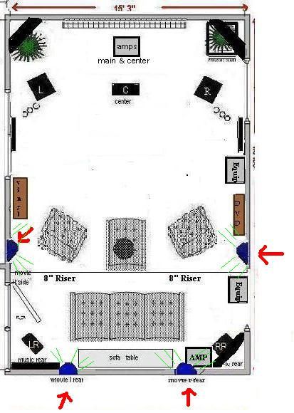

Here's a drawing of it, in a somewhat up-to-date setup. The dipoles, marked with red arrows, have a null at their center so if you are right on them, as the front row is, they are not blasting. And if you are off them, you are hearing them and at least 1-2 others, likely the fronts:

Net/net, it CAN be done, at home, with dipoles but you have less than perfect music surround capability. If most of your surround needs are movies, you will do well with dipoles and 7.1 over 5.1 (cuz the envelopment and diffusion of sound across more people). If you need to stay 5.1 then that's ok too, as long as you bring them back from the 90 degree sides to more like 110 degree (called the ITU setup in music surround world). Stay with dipoles, though, or you'll still be blasting Aunt Nellie as she gets the corner chair. Good luck.
